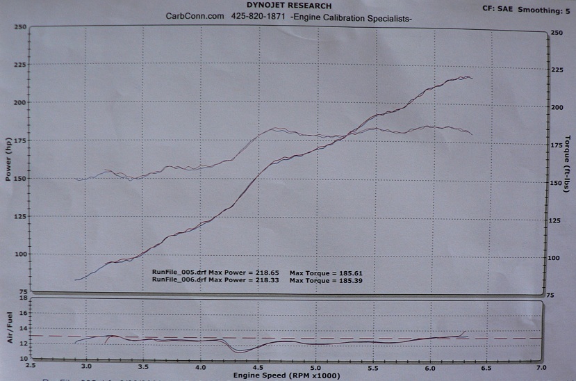

I had the car tuned and dyno'd on Thursday and the results are 218 RWHP, torque is 185, achieved around 4600 rpms:
Dyno results - 07/02/2009
I posted the map on the GoTech page along with a description of the setup.
Assuming 10% driveline loss, the engine is making ~240 HP at the crank (a little more than a stock 164Q).
I still have quite a few things to to - the map is generally good but I need to adjust it to start easily still.

That is fantastic power, especially considering that the engine is very mild engine. You should have 0 problems passing emissions.
What was the peak ignition advance and at what RPM did you have it at the peak?

Congrats Mike
Power is excellent torque is a little lower than I expected.
It will be a blast to drive enjoy.

hmm just below 4500 you seem to run a bit rich and there is a big increase in power. I would say at WOT you might want to run richer like you did in the bump.

ALFA GTV6 GP wrote:Congrats Mike
I think the torque is pretty close to what it should be ... I have 185 at the rear wheels. The 164Q specs shows 202 at the crank. Presuming the same 10% driveline loss, that puts me right at 205 ft-lb.
The car basically has no back pressure, just twin 2.25" side exit exhaust pipes which might account for the relatively lower torque gains :?:
Its massively loud!
Z, I'm not sure about the total ignition advance - will need to look at the map again. We used Chuck's map and tuned form there, so the ignition advance is probably similar.
Barry, this car has the larger 45mm intake runners.
slyalfa - well noted on the richness around 4200 - I'll ask the tuner (Alex at Carb Connection - excellent work BTW :)). Also, the mixture goes leaner around the rev limit which makes me wonder if in fact the 164LS injectors were tapped out there. Can I determine the duty cycle from the GoTech interface?
