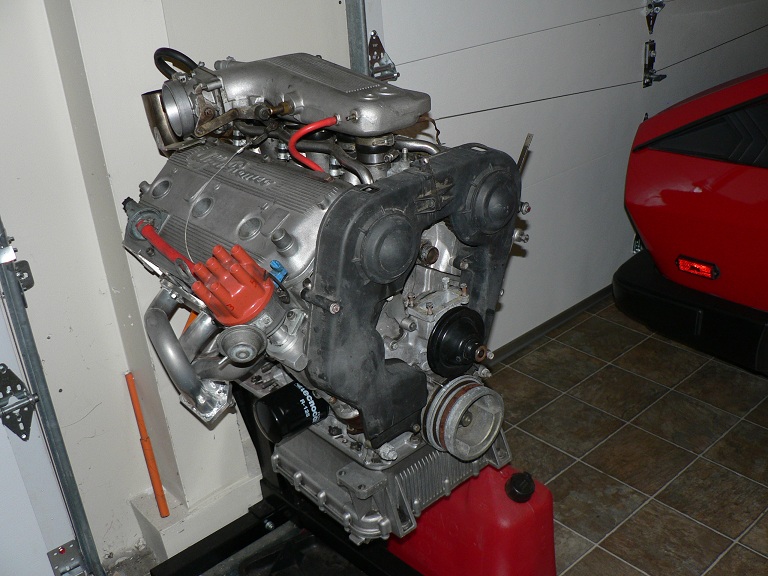

Hi:
I am preparing for a track day - first one in years!
There is a Pacific Raceways lapping day on September 2nd. I will use that as a shake-down test for the engine and to see if I like it.
I still have the old engine... worst case scenario I can reinstall that.
Zamani has first dibs on the headers if I can ever bring myself to part with this engine!
Right now I am preparing the car - changing the brake fluid, getting a leak in the radiator fixed. Details to follow...
