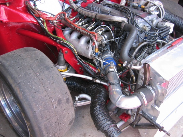

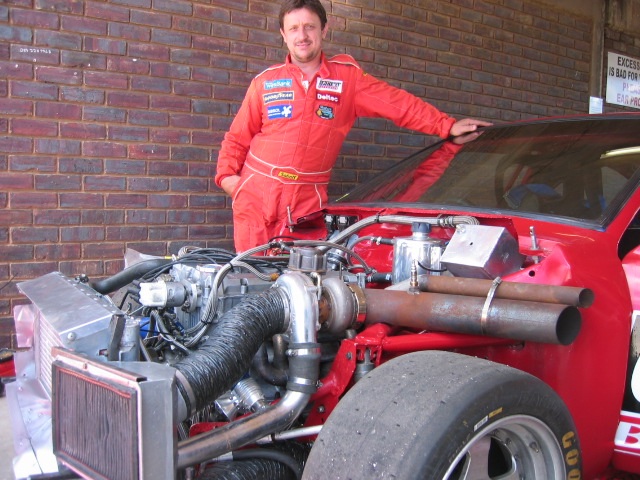

450 plus plus hp turbo.

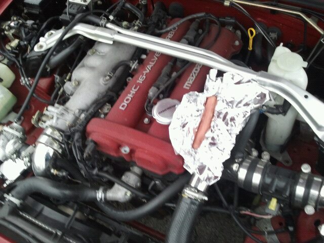

Sweet, now we have one more use for you turbo folks. Happy cooking!!!
Wouldn't want one now, it would de-laminate my CF hood

CF hoods are delaminated by hot dogs?? Nice quality dude!!

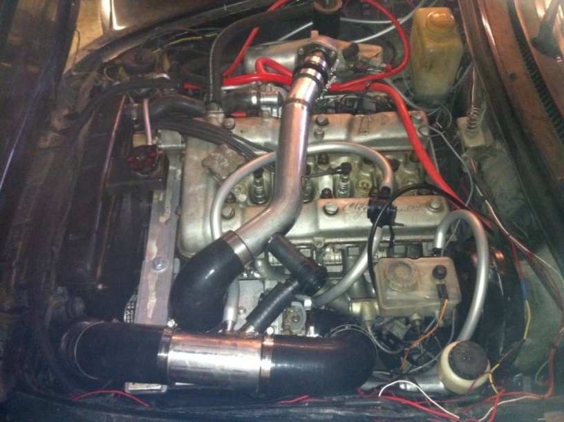

The newest superchargers can deliver 200-250hp and be very civilized. Most people don't realize how efficient the newest units have become. I'll add a picture of my Spider with the Sprintex unit. It's running but not driving yet. My real life has really slowed down my projects and the Spider is always put behind the customer stuff.
Will it bolt up to the 1.8? I think so, looking at the pictures it appears all the same mounting points are there.

Oops, here is the picture

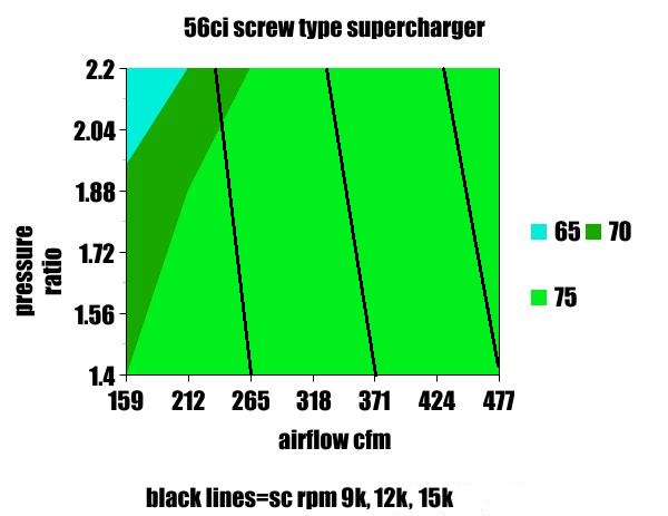

Compared to the old MP62 supercharger I used on the V6 and the 4cyl supercharged Milano, this thing is a huge step forward. The old blower had an adiabatic effieicnecy of about 60% through most of the RPM range with a peak of about 66%. That wasn't bad 10 years ago, and at or below 10psi a more efficient unit wouldn't help that much.
This new type has a peak of 75% and will be there most of the time. I wrote a new version of my supercharging book and updated it with data on the latest superchargers water meth, etc. Here is a chart from the book that's pretty accurate for the supercharger on this car.
To put this into perspective. At 14psi, this new supercharger has about the same discharge temps and drive power numbers that the older unit has at 10psi!

Greg, in terms of hardware/space utilization, I can see the pictured SC kit and our std 1.8T are very close. In fact, with my air/water IC (modified/enclosed std IC) I can see switching from turbo to SC a very easy swap. Maybe we should think about working on such a pilot project. The 1.8T ducting/throttle will do just fine and the routing is very close. The only other addition would be the std 1.8/2liter exhaust manifolds or -why not- headers.
