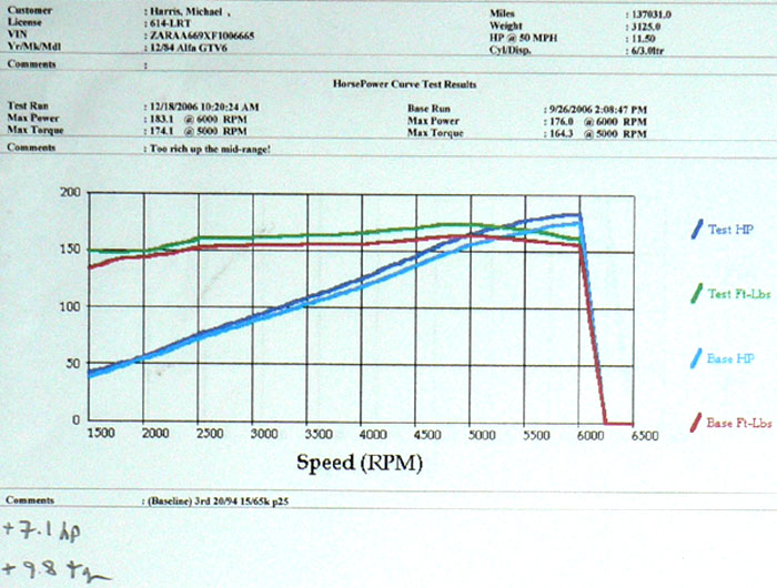

I had the car dyno'd and recorded again - this time with a straight through pipe replacing the rear exhaust section.

Any improvements in the power department?
Michael
Posts: 517
Location: Seattle, WA, USA
Post by Michael »
Yes, max power went up 7.1 Hp (to 183.1) max torque up 9.8 ft-lbs (to 174.1).
I should also say that the car had a pretty crude straight pipe installed - they used a crimper, no mandrel bends. It was welded up for temporary use, just to get the sound recording. With a proper pipe, you would doubtless see an even bigger improvement!

Here is the graph - the baseline was the one done a few months ago with the stock rear pipe - new test is the darker blue line.
