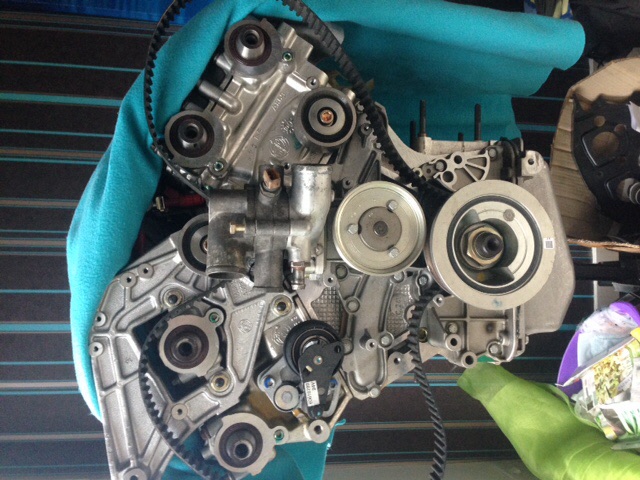

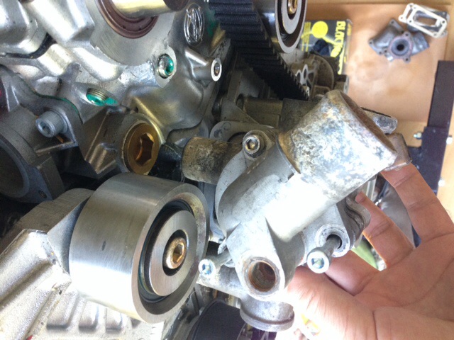

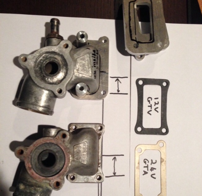

Some pics of a water pump adaptor plate I have been working to make the conversion easier with the motors that have the chain driven oil pump . Due to idler pulley being much lower on these motors the thermostat housing totally clashes and is also off centre for the two pipes from the thermostat to join up to the head . Idea is to cut off flange of Gtv/75 housing and weld new flange into position . Then once welded port out the opening to get the same size as the original and also remove edges . As two of the bolts will be under the housing I have made two tubes in order for the bottom flange to be secured . Bit difficult to explain but will show pics once I'm finished the three I'm working on .
From the shape of the two gaskets in pic it can be seen clearly the mods needed but even then it's in wrong position hence whole new flange .

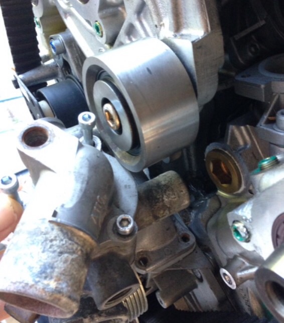

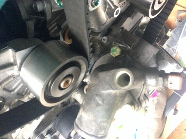

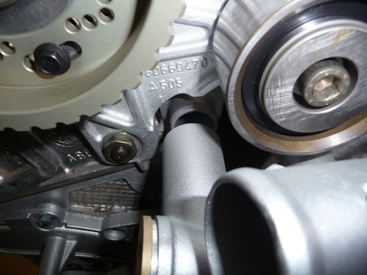

Pic shows interference of the lower idler bearing and using standard housing with minor adaptions . It cannot be done . Also so does not line up to pipes
Black pen line shows where to hole saw . Note if you go to big it definitely weekend the support for the bearing as there has been a failure from to much meat being taken .

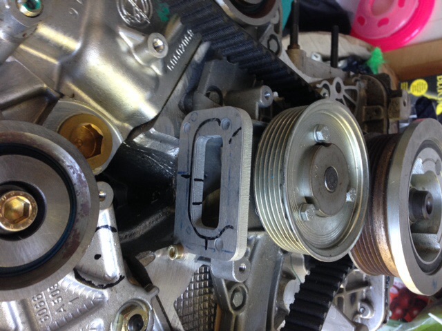

Pic of thermo with new flange . Can see pen marks where it will be ported out to get water flow . Other pic shows clearance from bearing plus belt

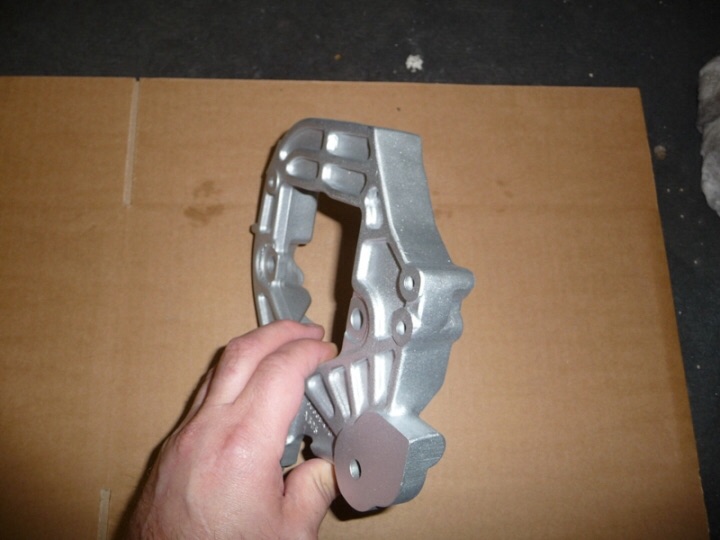

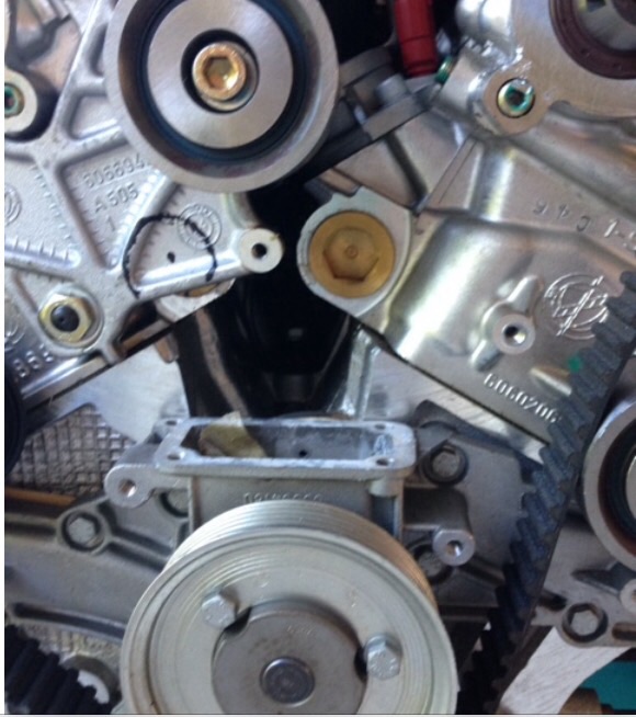

Noooo, you got it all wrong , that's just a plate in front of the head which has a brass bung behind it . These just screw out and are replaced with the ones from the back . Just a simple swap , probabably easier than changing a spark plug !
I will post another pic.

Look in pic on plate / bracket where hole is cut out

Oh yes, now I remember. The chain driven oil pump engines have that aluminum bracket.

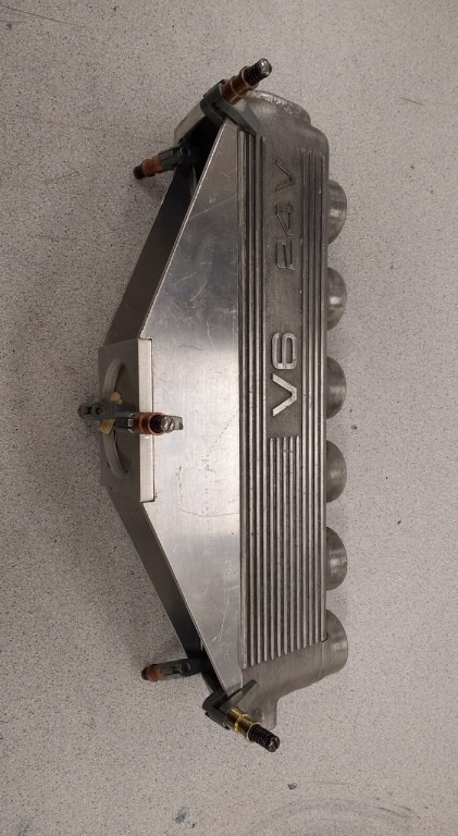

While I was drawing parts to be cut I did plenum again . Also working on adaptor for oil filter / adaptor do you don't have to drill in block but I think I will only finish that next month . Just digging up some old dims for coupling cage as well . These work really well . The black 75 that raced at Brands in the weekend . Some pics to follow.

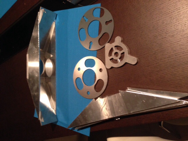

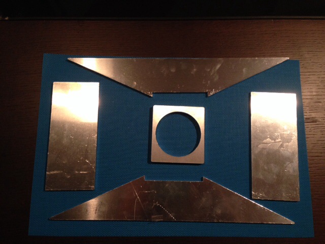

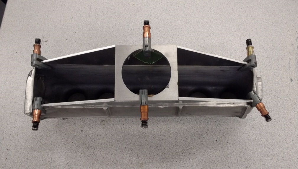

Been a while , but in spare time been making plenums up from parts I laser cut ages ago . Some pics of it tacked up
