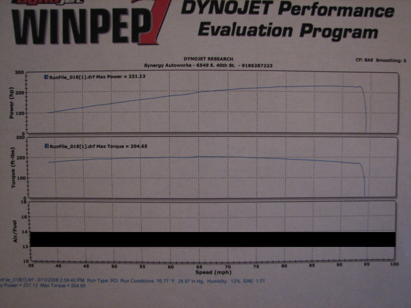

After delays due to bad weather and the need to go work at my real job, I finally got to the dyno shop today. Results were decent, although not quite as high as I had hoped.
The engine put out 231rwhp at about 6500 rpm. I will put the dyno sheet up tomorrow. I feel this is a respectable number for a 2.5 with 10psi and 8.5:1 compression. However I had expected about 240 and hoped for just a little more. I think I can squeak the numbers up a bit more with a better heat exchanger. Of course ditching the original catalytic converter would help power for track only event. The cat back system on this car isn't too good either.
After driving it, I think its performance is pretty close to the 265rwhp 3.0 we built. The 2.5's 4.10 gears and 7000rpm redline partially make up for the 34 horsepower deficit. The 2.5 also has a lot less torque which seems to make tire spinning less of an issue.
Note to Barry and Jim K. : I was very surprised how much timing this thing wanted. We ended up with about 36 degrees total advance from about 5000-7000 rpm. That's a lot of timing with 10psi.
Hi Jim, I actually started with your normally aspirated numbers for these cams, and they were darn close. However I was surprised it wanted even more timing, that's contrary to conventional wisdom.
Anyway, here is the graph. All testing was done in third gear to keep the tire speeds down. I didn't want to be standing next to an older tire at 4th gear 7000rpm speeds.
This is a photo of the dyno sheet so it's a little tough to read. Here are the numbers, max power=231.13 max torque=204.65 outside air temp 76.77F, atmospheric pressure 28.97"HG, humidity 12%. The dyno is supposed to correct for these factors.
I will put a video up soon.
Hey, do you guys think that torque curve is flat enough?
