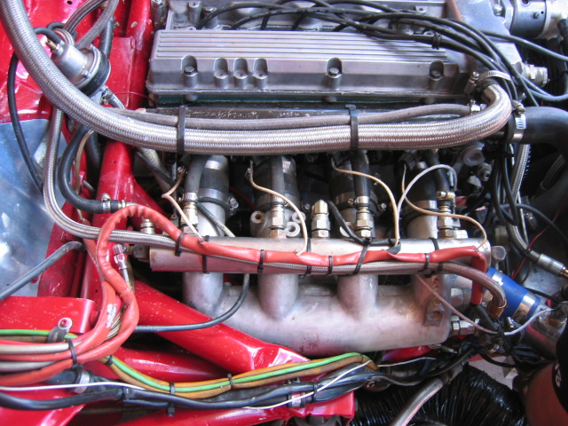

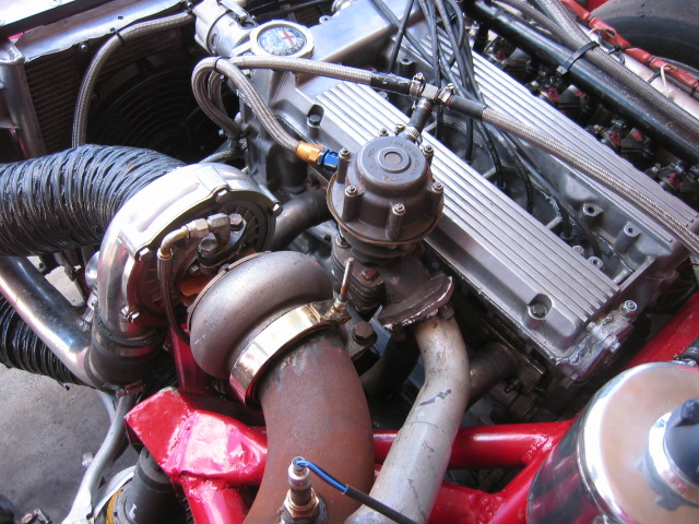

Some pics of Fracos car in our series. I have posted before but its always interesting to see other running projects.
- IMG_2853.JPG (154 KiB) Viewed 9866 times
- IMG_2848.JPG (156.03 KiB) Viewed 9868 times
