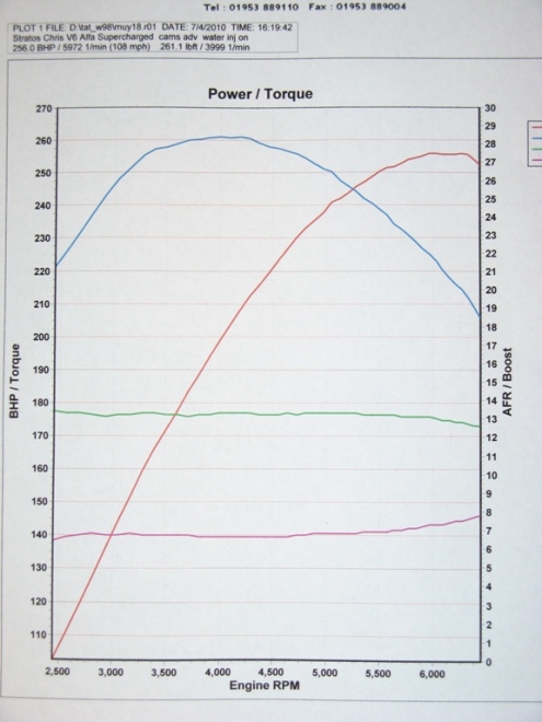

Right, results time. As anticipated due to the low boost figure, somewhat dissapointing. 256bhp/261lbft
Plot attached. Rise in boost at top end suggests it's starting to flow-limit maybe. Advancing the cams a degree saw no change in boost, few bhp more power, bit more torque. It didn't want an awful lot more timing than it had, which surprised me a bit, but it wants what it wants and that's that. I reckon it would take a good deal more boost without problems...if only I could find out where it all went!
I'm going to leave it be and just enjoy it for a while now, but longer term, I might be tempted to have a bit of a fiddle to try and find some of the missing boost. Most likely culprit is probably cams, but before I get to that, I think I'll try removing the charge cooler, or at least measuring pressure before it - I've had doubts about that from day 1 really.
Still, it's driving really nicely after mapping and pulls well enough.

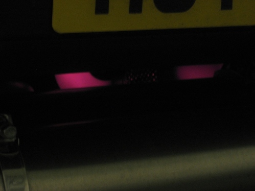

- glowing.JPG (45.11 KiB) Viewed 11490 times
- power run small 495.JPG (108.54 KiB) Viewed 11490 times

Nice pics! Thought for a mo you had some neons on board til I worked out what it was!! ;o) Disappointing as you say on the one hand but good to know the timing waqs pretty much there and now you can concentrate on enjoying it while you work out what job comes next!!
Look forward to hearing about the next steps.
