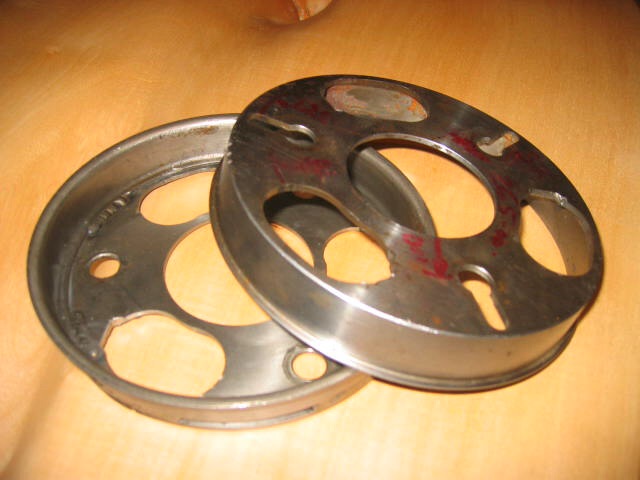

Yes, that's no BS. I recently built a 24v and put on it a rwd flywheel from a gtv6. The 3 stud bosses are HALF EATEN on one side due to the repeated impact of the 3 driveshaft bolts/nuts. But strangely enough, it is NOT the side of rotation! I wonder under what conditions this contact occurred. If you look at the angle the donut has to distort for this to happen its unbelievable! Its a miracle they last as long! Here's a pic of the flywheel, check out the boss, with wear almost down to the bolt! All 3 are the same.

It's about 18-20mm movement as I could see chips on the powder coating where the nut catches the cage . We also had not standing starts so it was probably from the second gear hairpin bend on our track .
The non coated cage shows more aggressive marks and their was no coupling failure at all . Coupling still looked very good .

That tells me that the cage will lengthen the life of the flywheel bosses, studs and the guibo! One of the problem with an exploding guibo is the stud may or may not be parallel. anymore.

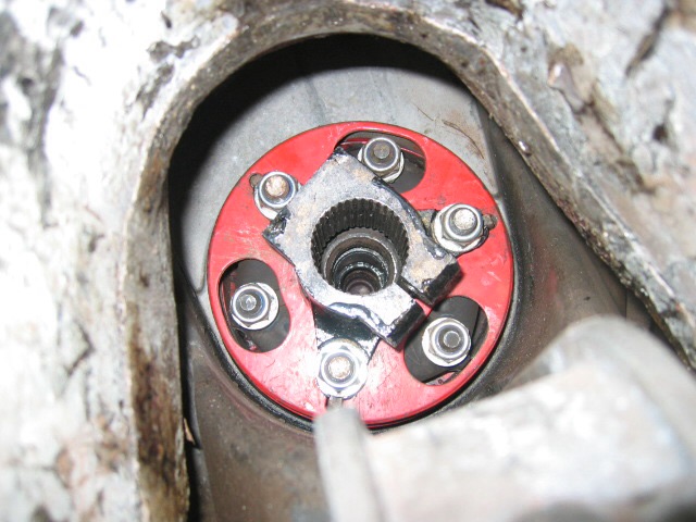

The wear shows how much the disc twists which is what it is designed to do. My bet is that the most damage (wear) to the discs occurs from radial growth from high rpm centrifugal forces. How much clearance is there between the cage and the outer part of the flex disc?
Since 1994 (~60K miles) I am on the 2nd front disc with a 300 ft/lb motor but I keep revs around 6500. This experience is what leads me to believe its centrifugal forces not rotational torque that does the damage.
Any first hand experience with the aluminum discs with the rubber grommets seen on the Biscione site some years back?

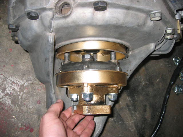

Re: 166 24v into 116 GTV
Hi Brian
It's a tight fit . You have to really use a bit of hand strength to squease it into cage . What you actually are doing is making the guibo/ coupling round by fitting it in cage .
Here's one on my other car . ( the Gold member phase
If you want to adjust the limit of movent you can . You can't destroy a coupling with these . Practically impossible .

Kevin, That settles it in my mind. It is an exoskeleton for the flex disc.
