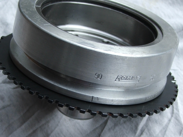

It is possible to obtain a 60-2 after market trigger wheels and fix them to whatever pulley you need. Often this involves custom making of the pulley assemblies and additional machining to fit the trigger wheel. Not a cheap exercise at all.
Here's one I use for the twin spark engine with Motec. This require modification to the pick up mount and a the use of a BMW pick up to get correct centering and proximity.
This arrangement clears the water pump and the timing chain housing for the four cylinder engine.
I am only saying this to illustrate the principle for you.
Harmonic Balancer with 60-2 trigger wheel.jpg (241.58 KiB) Viewed 9167 times
Harmonic Balancer with 60-2 trigger wheel 1.jpg (213.33 KiB) Viewed 9169 times

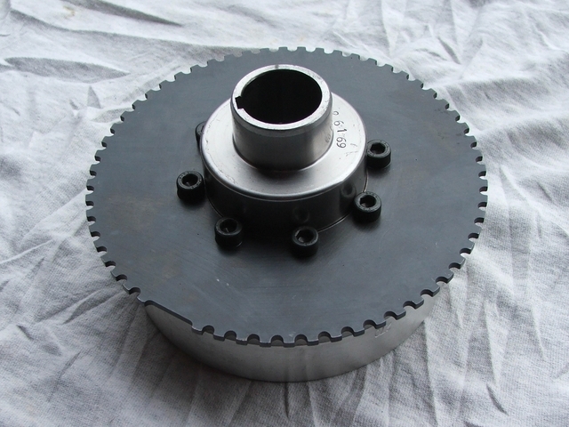

Re: New Intercooled Supercharged GTV6
Hello MD,
the problem is solved allready. 8) I bought a 75 Motronic pulley which has the
60-2 ring allready on it.
Engine is laying in storage now, car it was intended for has been sold. :(
Show us a photo of it please.
