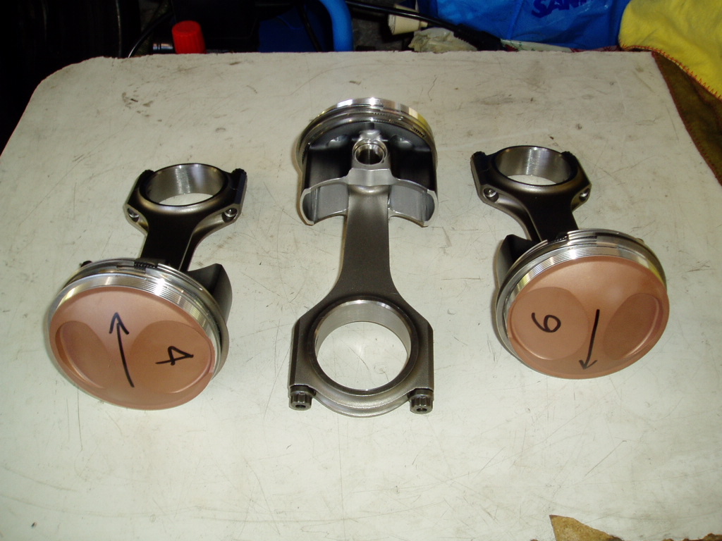

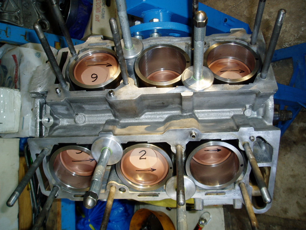

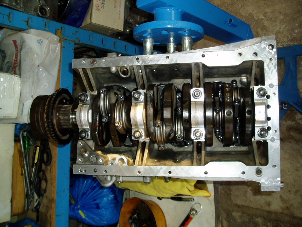

All right, let's get back to some 6cyl stuff. Here are some pics of the current build. I'm stuck at this stage as like I said, I'm waiting for custom valves from UK and a crank scraper from Ishihara-Johnson. The rotating assembly was of course balanced appropriately for the different component weights.
- Topside view. Notice the little black dots on top of the liners...it denotes the point of larger bore dimension. Difference can be up to 0.01mm even in NEW liners.
- P7170009.JPG (210.17 KiB) Viewed 8104 times
- 3liter Short block...of course the crank pulley is degreed!
- P7170007.JPG (211.47 KiB) Viewed 8103 times
- THS/JK rods and JE/JK pistons
- P7170001.JPG (213.92 KiB) Viewed 8100 times

Lovely picturess, nice to see the progress, I definetely love those pistons, tiny skirts on them too

Hmmm, same story; that's how the skirts in mine ended up so small! I wanted a way wider one for longer life but I was unpleasantly surprised
when I opened the box...they will have to do!

Yes, beautiful set from Ross. Really nice quality but stock everything except the slightly lower skirt.75evo wrote:Mats,
