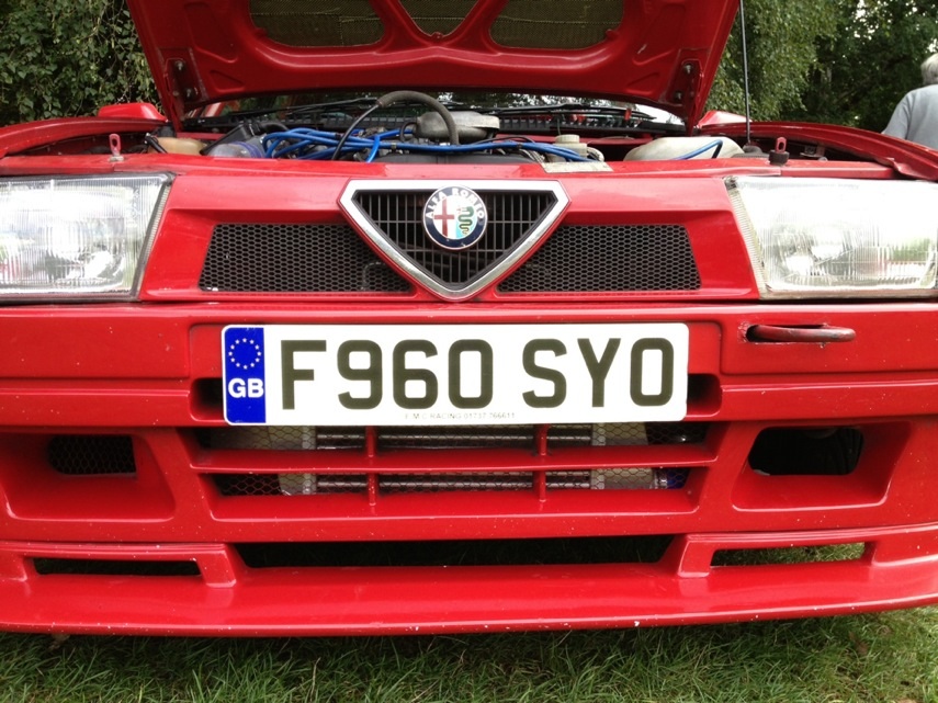

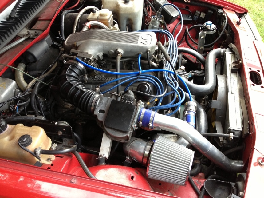

As its on same subject of supercharging a 75 , I snapped some pics of his very neat rotrex installation on this car at our annual AROC gathering last month .
- image.jpg (231.59 KiB) Viewed 8426 times
- image.jpg (245.2 KiB) Viewed 8426 times

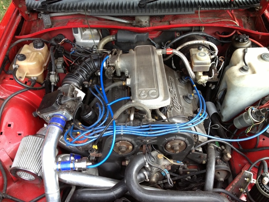

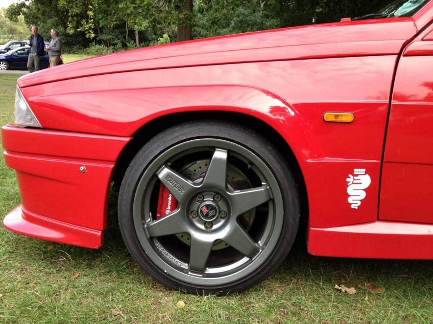

Some of the car which was properly sorted with some big torsion bars and brake upgrade . There just seams so much space in the engine bay .
- image.jpg (225.38 KiB) Viewed 8426 times
- image.jpg (207.76 KiB) Viewed 8426 times
- image.jpg (225.41 KiB) Viewed 8426 times

Wow nice! A blow through setup. I would like to put this on my 3.2! Do you have the owner's contact?
Re: Building the supercharger to the engine (75 3.0V6)
It's rare to see an L-Jet setup with a supercharger, but it can work! Looks like this car has no AC, and probably not much more than 5psi. Not how I would have done it, but very cool, I like it.

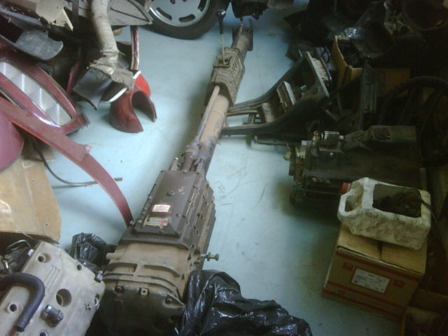

This is the one I measured up a few years ago . It just seemed to much work at the time . Little did I know I was gonna cut the car up and put box in front . And I did not want to touch the Dedion .
I think it will still be cheaper reinforce clutch housing , strengthen up box on main shaft to stop any play or whip as it just takes fractions to break the pinion . Have you checked the clutch housing for any cracks ?
