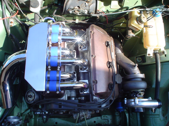

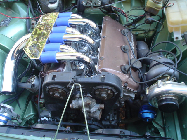

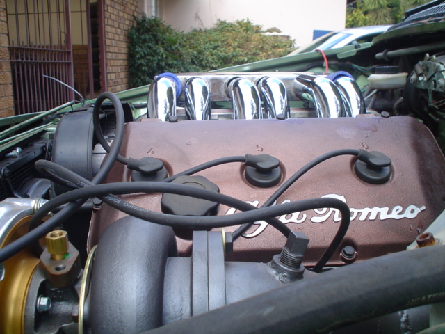

Its a slog Garth..Using the carb heads Ive had to manufacture a full intake system and plenum that also looks good ..
Well,I got the finished intake back from my platers today..Thankfully I can now forge ahead..

Barry once again excellent work.I was at Barry's place on Monday and was amazed at the work involved in gettng the injectors to fit in this set up. :shock:

Are the heads meant for carbs? The intake entry point is not the same as injected motors. I wonder what shape of fuel rail are you gonna use...

Zman,all will be revealed soon..one obstacle at a time...

This is for Brian Berger..the reason for the carb heads and the custom intake is so we can still use the std. 20l bonnet/hood.
Next time though its a 2.5 one!!!!!!!!This is a lot of graft..
Low bonnet line...
Low bonnet line...

Why didn't you just use the 164 intake setup? Must be something I'm not seeing. I thought the 164 setup will fit under the Alfetta bonnet.
That looks great Barry. It's a lot of work just to use an Alfetta hood, somebody there must really like that flat hood.

Zman,Yes..164 stuff would have solved a lot of problems..Was not available at the time,and I had a set of carb heads that Id prepared 15 years ago for a "Barry project engine"You know,that elusive "my " engine..best case of the barefoot cobbler here.
But thats all changed,Ive finally got a car at the paint shop for myself!!
Must say I think the custom stuff looks better than the 164 stuff..I enjoy doing things differently..
I am amazed no one has criticized the plenum here yet..I got some secret "for your eye`s only"stuff inside..Nah,Its simply a deflector so that those two center cylinders are not biased..
Thanks Greg-You know,the customer is always right..untill I lose it..haha.
