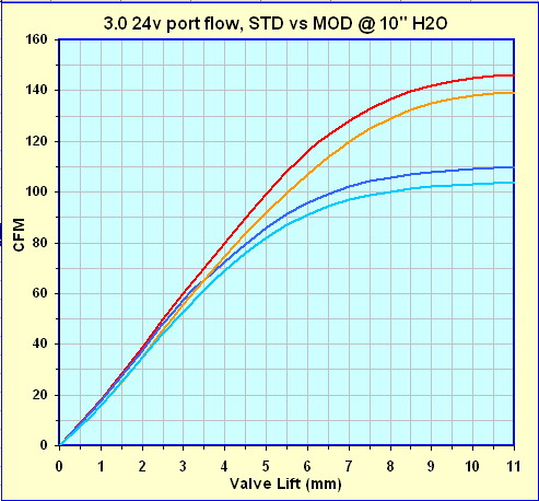

That's 236 engine power. For comparison on the same dyno, the std 3liter cat engine showed 171hp (from an advertised 184).
The attached 24v flow graph is for a very mild porting job, more of a cleanup (with the guides in place and untouched). For comparison, consider that a fully ported 4cyl M3 head goes to ~175cfm! I would think the Alfa can go to ~160cfm with a proper porting effort. The difference is made up from the bigger BMW valves. Still, a possible 160cfm is good for ~420hp according to Superflow.

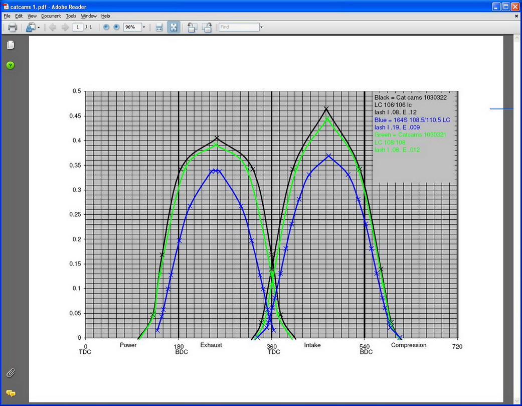

I was curious about the Cat Cams 1030321 and 22 so I plotted them in excel using the data on the catacams website. They give you lift at 0.1 mm, 1 mm, lift at tdc and peak lift. I had to add a data point with a faked duration at about 9 mm (0.35") lift to get the profiles to look right.
I also plotted the 164S for comparison.
Anyway, I'm no cam expert but wow, those exhaust lobes are huge! And at 106 and 108 lsa no wonder you have a lumpy idle. They also cut into the power stroke quite a bit which can't be too good for low end torque.
If you reprofile the cams maybe consider a shorter duration exhaust lobe which I have heard will often help low end torque but will not hurt the top end very much. Also you wouldn't need to spread the lobe centers as much to get down to the Shrick recommended lift at TDC. I think you would need at least a 115 degree LSA for either cam.

On Monday, I went to my cam grinder friend here and that's exactly what we talked about: shortening exhaust duration and generally altering the profiles of the #1030322 cams, since it doesn't look that I'll be using them. The man has possibly thousands of profiles in his data file and we narrowed our search down to those with acceptable lift at TDC, total lift over 11.4mm and LC's from 110-112*. We found some and we'll have a new meeting to compare and select what we think is best. I'm confident we'll find a good solution here.
