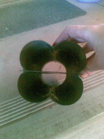

Obviously not attached to an Alfa engine, but I decided to build (tho yet to test) a prototype reverse collector style plenum chamber manifold for my turbo charged and supercharged Toyota MR2.
I didn't take a photo of the inside once I welded on the bell mouths, but you get the picture.
1 and 4 are paired together and separated by the internal devider from 2 and 3. This decision was made after watching Mats manifold simulation and seeing the robbing of air from adjacent runners. 1 and 4 (or 2 and 3) can rob from each other, but because there is the longest possible even spacing between their respective induction strokes, it should (hopefully) have minimal effect.
The idea behind this design is that there should be very little favoritism for any of the runners as each runner is in essentially the the exact same orientation to the plenum entry as the others:

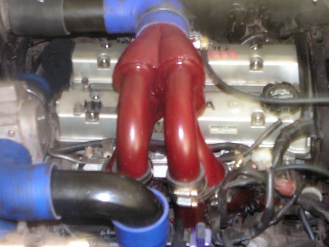

hmm kinda looks like a quad 4
2.3L 160bhp
but the later one was 190bhp
and the intake changed into this
