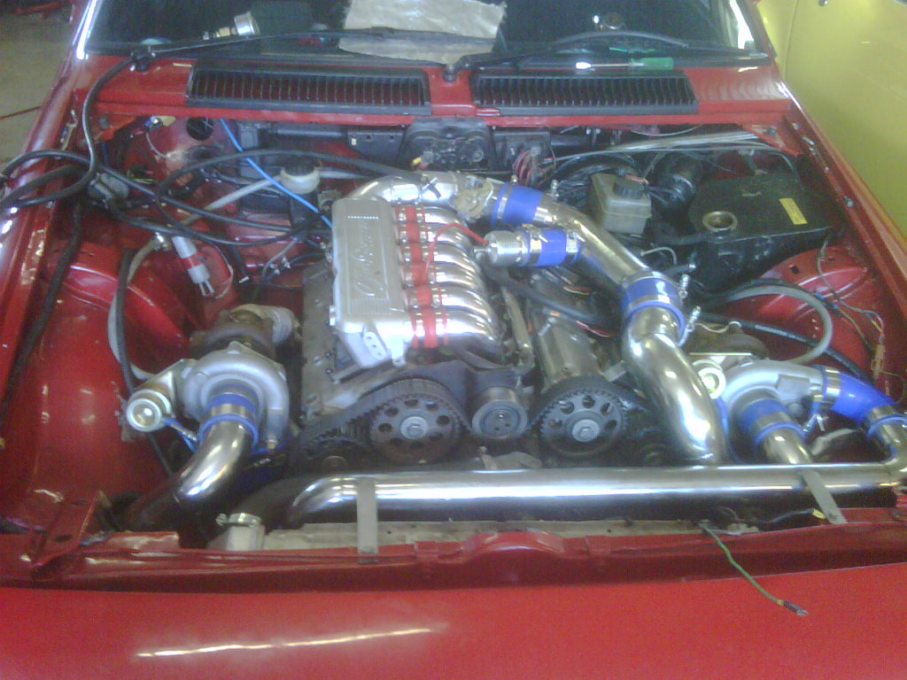

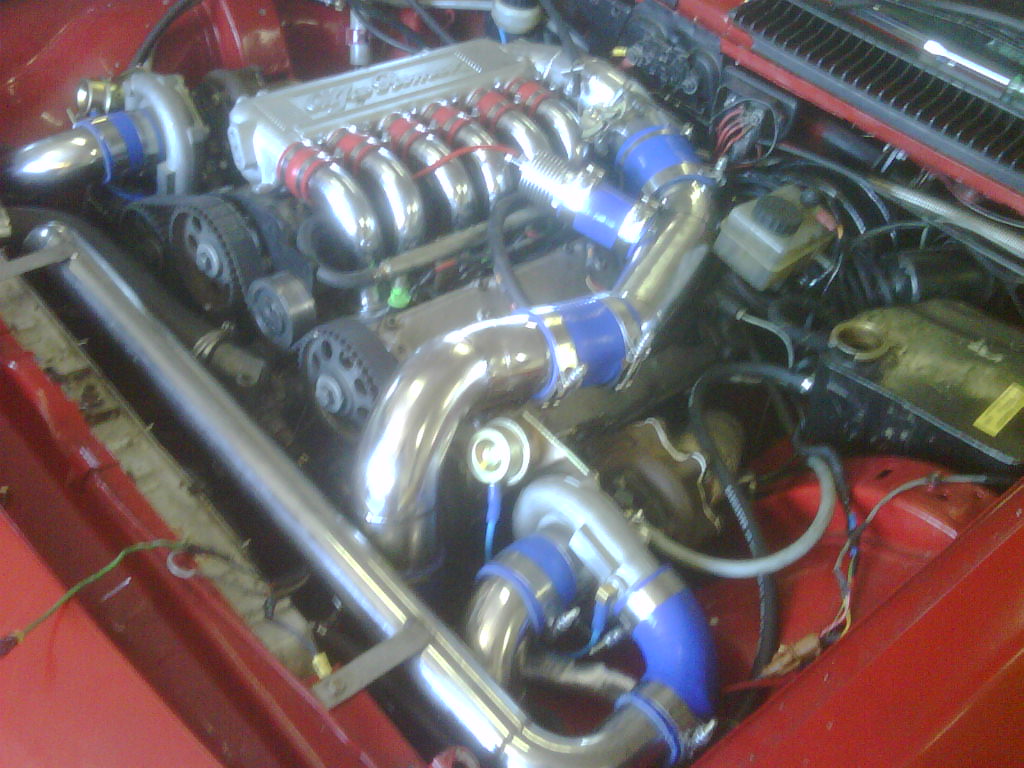

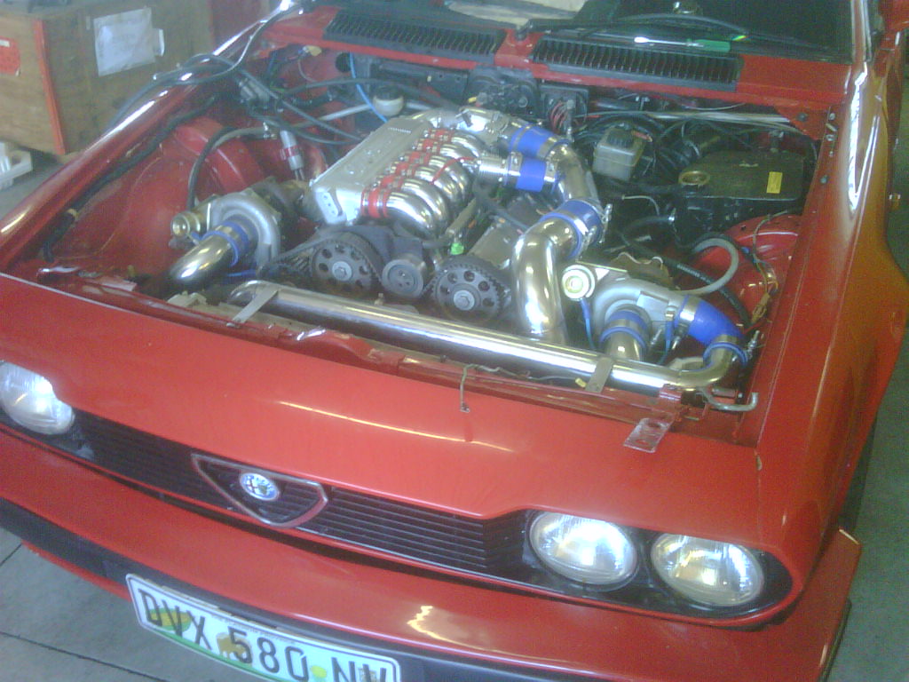

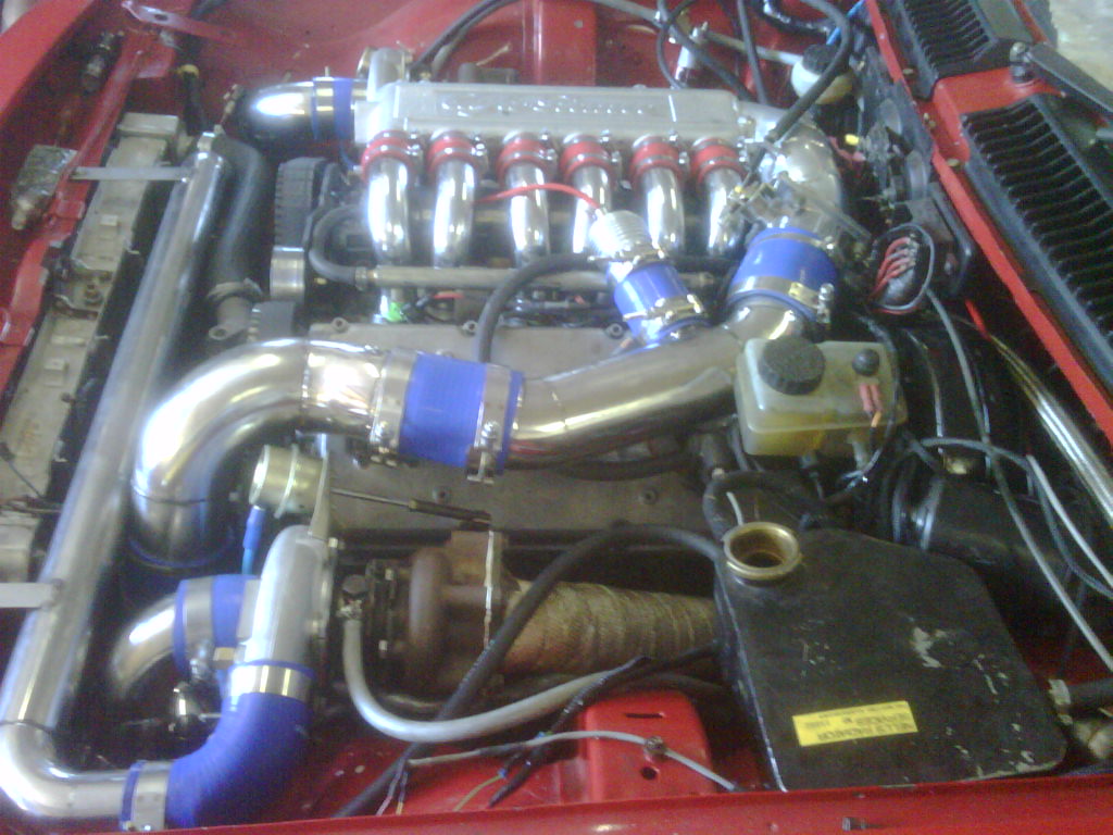

Pictures are not so clear but this is a new tt 24v . Its first dyno broke the front coupling. Motor back in and ready to go again but ne mods to drive train (dont ask what they were).

Wow, that all looks really nice.
Re: In the build...? Anything new being done..?
Its really tidy conversion. Cam covers are put on after all dynoing. Just dynoed my 3.2 GTV conersion (road trim with 63mm exhaust with two boxes out back) today with standard gta set up. An surprisingly
made the same power as two 156 GTA's that were at gotech to the exact kw.
My 3.0 race car with exact gotech but with GTA 2 spec cams , standard compression but with short exhaust (two 50mm out passenger door) still makes 18kw more which is huge. Conclusion its in those cams and short exhaust. But then again you cannot have that short exhaust for road use even if you do live in Africa.

Thanks for sharing Kevin.
That's a very impressive set up.

Thats a really nice setup, would be making very good torque indeed, looking forward to seeing what it puts out on the dyno,

MR2 , most run stock radiators if they are still in good condition with 156 fans. Two of the other tt's run bmw radiators but you have to cut the body. I ran stock radiator on my TT no issues.
