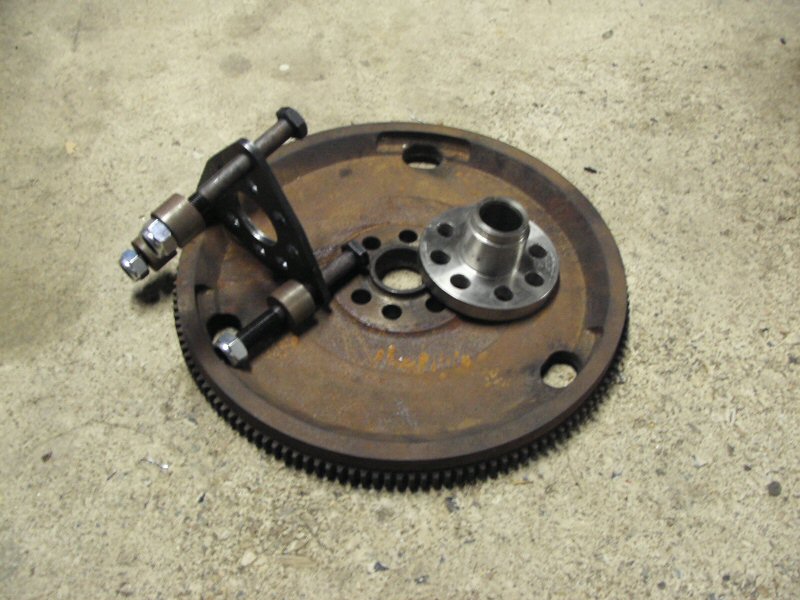

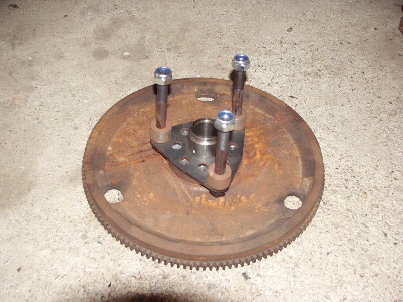

Z - you can use the GTA flywheel with a donut adaptor - Daniel has done this with his, there's pics somewhere and can probably supply drawings or the part itself. The GTA flywheel is only 8kg.

la_strega_nera wrote:Z - you can use the GTA flywheel with a donut adaptor - Daniel has done this with his, there's pics somewhere and can probably supply drawings or the part itself. The GTA flywheel is only 8kg.
mmm, interesting, i'd love to get my hands on those drawings, a GTV6 or 75V6 is hard to find, not to say nearly impossible to get here in south america, good solution and I can keep the 164 flywheel

Re: JK's v6 book
Post by la_strega_nera »
Here's the pics of Daniel's setup:
viewtopic.php?f=2&t=2016&p=22540#p22540
Dan used a 164 Auto flywheel, the GTA flywheel should be no different in terms of the adaptor.

Thanks mate, i've been thinking about doing the same on the V6 for my giulie, but the problem is sourcing good quality bolts for the crank, i'm going to look around tomorrow to see if I can find some.
What grade would you guys think would be good? 12.9 as per matfo's conversion?
Sorry Jim I hijacked your thread a little bit, i'm on the final stages on my first V6 conversion and i'm trying to define the best route to take...
I'm using a 164 12v by the way.
