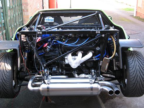

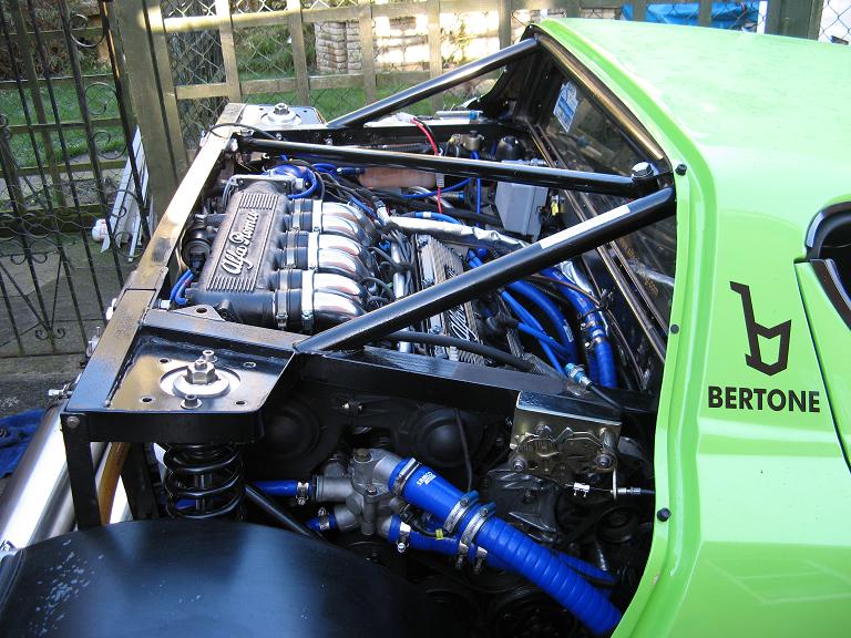

Not an Alfa, but an Alfa engine at least....
Finished installing the new LC motor ready to bed the cams & rings then put a few miles on it aspirated, prior to fitting the rebuilt M90 blower and getting it on the rollers.
All went well as far as bedding the cams went, but now I have a problem with the clutch release fouling the gear linkage...and my attempt at putting it right has ended up with me needing to pull the 'box again.
Still, the new exhaust sounds OK and all seems to fit as it should, and the engine sounds sweet.
Hope the new relase bearing arrives before Xmas.....
- side view small.JPG (107.81 KiB) Viewed 8163 times
- completed small.JPG (54.38 KiB) Viewed 8165 times

Chris,
That's a serious bit of gear there. Would you care to tell us more about it ?

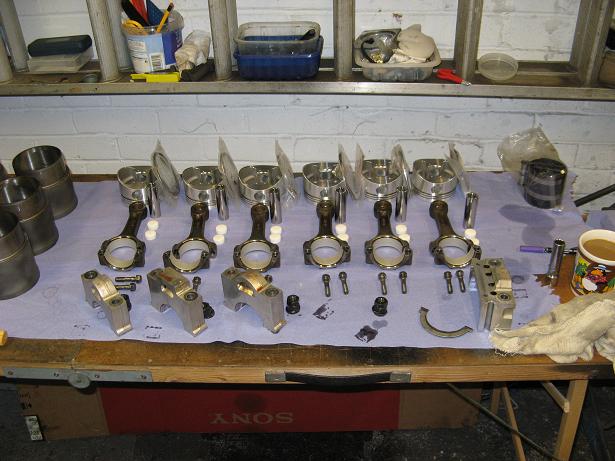

- Pistons! Start of the LC engine build with a set of Greg's Venolia pistons.
- pistons.JPG (60.84 KiB) Viewed 7983 times

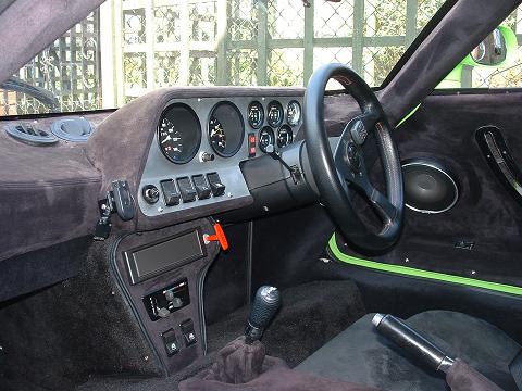

- Interior
- interior.JPG (51.96 KiB) Viewed 7983 times

Love the interior, very nice indeed.
You certainly revived that car from it previous condition, thats for sure!!

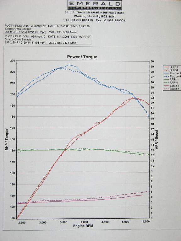

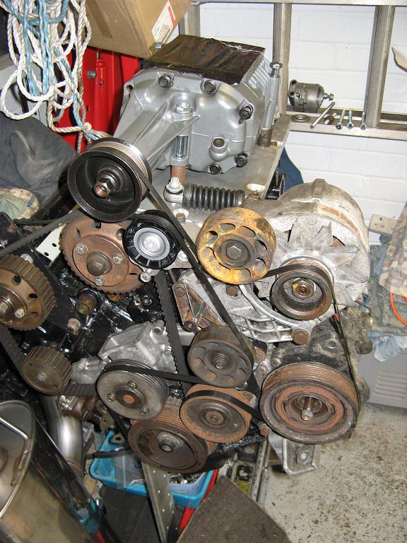

I'm not good with compliments, and I don't normally do 'proud', but I have to confess that the one thing I am fairly pleased about is the interior - apart from the seats which are Sparco, every single bit of trim and finish inside the car is my own work. I bought a used sewing machine and got stuck in! It certainly amused my workmates for a while - lunchtime, out came the sewing machine from under my desk and I'd do an hour. I also had to fabricate most things from scratch, apart from the dashboard moulding (which is Hawk and didn't fit my car) and the binnacle - again a Hawk item.
Anyway, since this thread is about performance etc...a couple more vaguely pertinent shots!
Mock up of the blower installation and a power plot from the dissapointing first attempt when it achieved a massive 5psi of boost.....and 1bhp less than aspirated! To be fair to it, it was far from an optimised map as we didn't see the point in carrying on with just 5psi. I nearly gave up at this point, but the guys encouraged me to have another go with a smaller pulley.
- Power runs - 5 whole PSI of boost.......
- plot small.JPG (57.3 KiB) Viewed 7903 times
- Mock up of belt run.
- belt run small.JPG (111.5 KiB) Viewed 7902 times

No Intercooler for the blower?
Give us some spec details. Please!
I have a Group A spec NA 12v 2.5 with just shy of 250hp (ideas in the works to get a little more), and turning to thoughts of apt and proper useage of the angry little bitch led me to a Stratos idea. Didn't really look into it. Turning a N/S donk into E/W for fitment would be tricky, so I'd always thought I'd go 12v 3.0 and force some air down its'' throat. It seems to me to be a car where you can actually build a modified example AND almost entirely recoup your investment. Not to mention driving something with absolute italian pedigree, in a shape that is top 20 for all time sex, IMO, and the idea of massive torque in a short mid engined wheelbase that could teach me more than a few lessons in control.

I'll start a new thread then. Not quite sure where it should go..probably performance.
There is an air/water cooler grafted into the inlet plenum. I'll post up some pics in teh new thread and leave this one to more GTV-related talk
