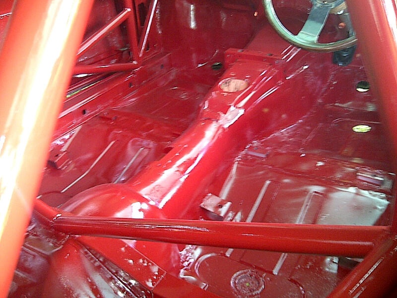

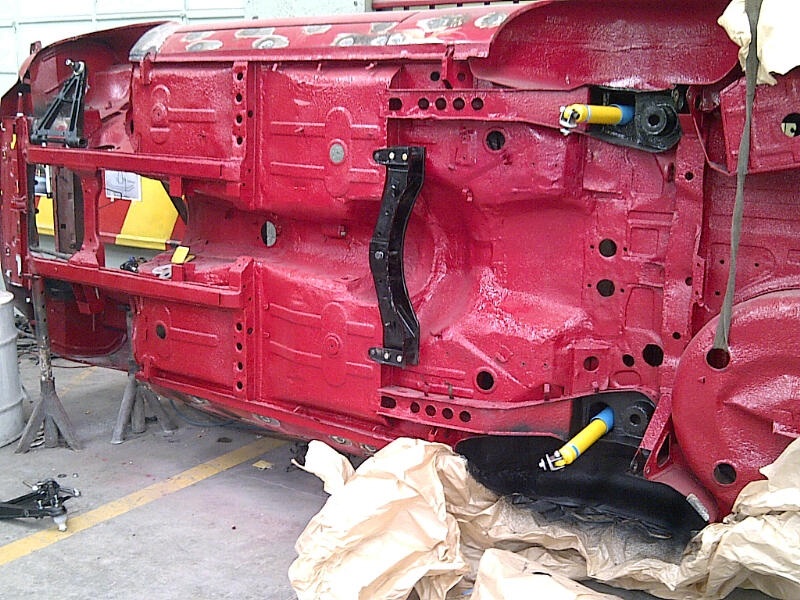

You can see from these pics how much work it is ( and costly ) to create the space .

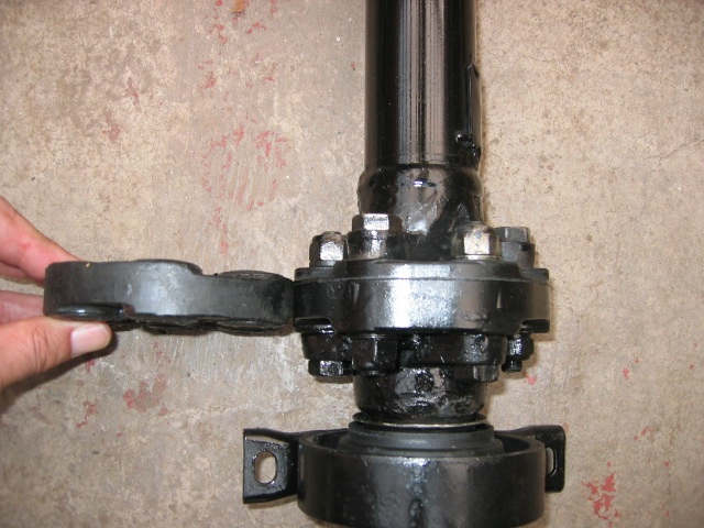

The standard Alfa centre coupling is rubbish compared to the BMW .( 1980 design on 118kw vs 1995 design on 160kw) It does not have any strand or thread in it , so its just like a rubber ball which will split with big power motors only . The BMW type is like a car tyre with huge amounts of windings in it . I should have the code of it tomorrow . Beware there are fake BMW ones without thread inside . This pic shows its only 5mm thicker . The standard one is next to the prop . A coupling cage on the front coupling should give all protection you need as that's the first one that winds up under acceleration then centre then rear .

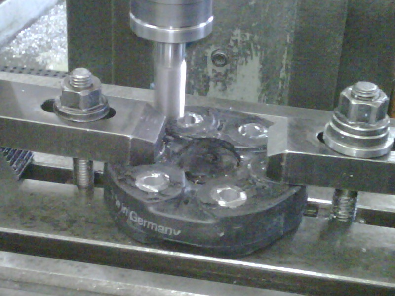

Greg , I shortened the prop by 5mm as I wanted it to be perfect but ironically their was still gap while the other two cars I did not change prop and it was the normal 2minute struggle . Because I'm always using lift and not lying under car its really no problem . I'm still waiting for code . I posted a pic ages when I tried to remove 5mm off coupling . Was pretty stupid idea as it launched across the workshop when skimming the rubber :oops:
