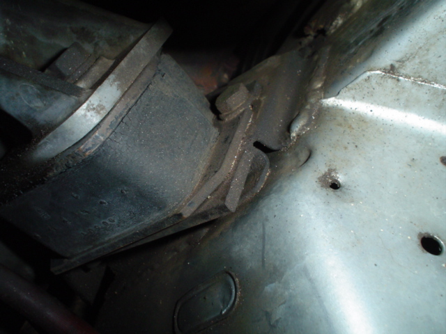

F,Took the pics quick..Dark outside though..
The front section of the gtv6 prop,remove at the wels,cut the exsisting Giulietta prop -measure overall length-and weld on..done.Same averall lenght as the original Giulietta prop.
The welded adaptor plates as in the pic.The rear bellhousing bolts onto the std. position and you will see the gtv6 mounting bolt hole will line up with an exsisting hole or stud on the car.The plate gets a tapped m8 hole and stud or bolt for the gtv6 mount.

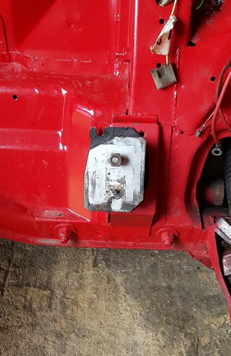

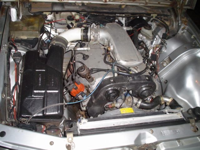

resurrecting an old thread
just to clarify the engine mounts once again
Attached is 2 pictures of where I presume the v6v mounts sit in relation to the 4cylinder chassis
the 3rd picture is from an earlier post where someone a 3mm- 5mm plate has been welded to the 4cylinder chassis mount showing it in the same position
I have measured the mounting points on the gtv6 chassis and everything seems to line up perfect
thought I would share with you all and appreciate any comments before I weld a similar plate into place

Re: Giulietta V6 conversion
file upladed incorrectly so heres my second attempt
and the third
- 20151206_142052_resized.jpg (146.63 KiB) Viewed 18272 times
