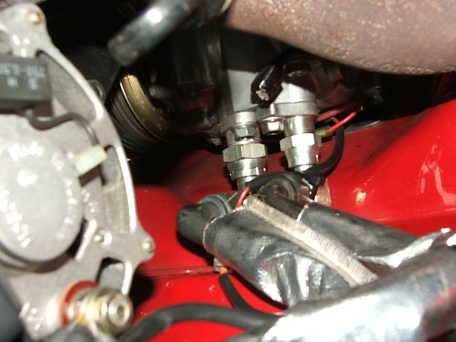

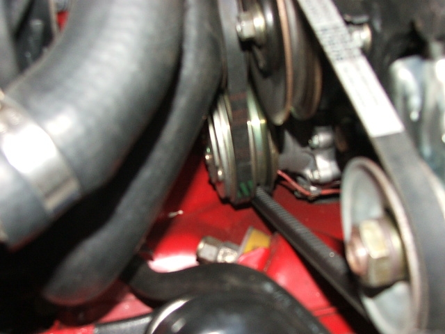

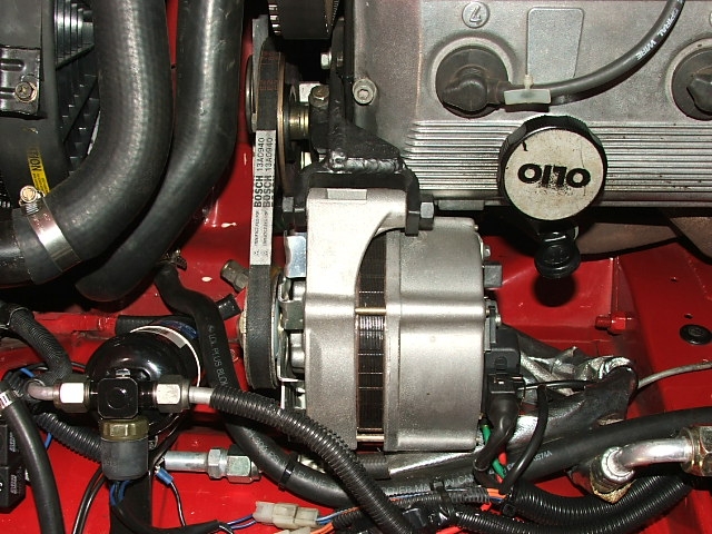

I have customised my original system and use a small Honda compressor mounted on the LH side. It sits directly under the alternator in the first photo. Unfortunately the autofocus went a bit haywire for the close up. I use 134a gas and it works very well. Yes it is barely noticeable as a power drain but if I think I need the extra power during certain times, I just simply turn it off and put it back on when Iam finished. Best of both worlds.
