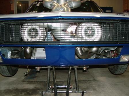

That's some car. It's rare to see an old school blow through carb set up. Few people can make those work out well, it takes a serious expert to get one set up right, but blow through carbs are still kicking but at the track in the U.S. In fact the world fastest pump gas car uses blow through carbs.

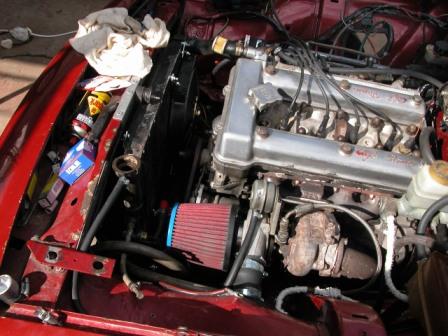

I've blown my budget and planned time it would take to finish this turbo kit

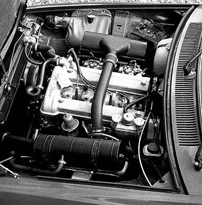

Thanks Greg i'm interested what factors effect lag because 7.1:1 comp ratio(turbodelta)(i haven't driven one myself (yet)) but read Wheels car review from 80's + Barry's white gtv, the turbodelta very tractable, able to pull away low rpm + high gear etc but others say nothing happens till 2500rpm then goes like hell????
So maybe turbo well matched? spins up fast even with low comp pistons, but ultimately too small for big hp. (fit bigger turbo = off boost slug?)+ i suspect such a short distance between turbo/comp and plenum may help vs large front mount air/air intercooler with longer dist/volume etc
Anyone know who's this gtv is? it was on the old site but not much info
I think with so many "cheap" 2.0 GTV's in Oz especially on ebay etc you could get a great blow thru turbo project/club car going.
It would be the most "ecconomical HP" too per $, i just wish Alfa Australia imported alfa 75 turbos all those years ago!!!!!!!!!!!!!
3.0 V6 with efi very expensive from wreckers here, prob cheaper to buy 164 for the engine then sell the body/parts to reduce cost but thats just to get a 3.0 engine, let alone start modifing it $$$$, and the cost of bell housing/exhausts/sump/oil pump etc if you have 2.0 4cylinder to start with! plus you wipe another 164 off the planet
A 2.0 blow thru turbo can make more HP for the $............mho
