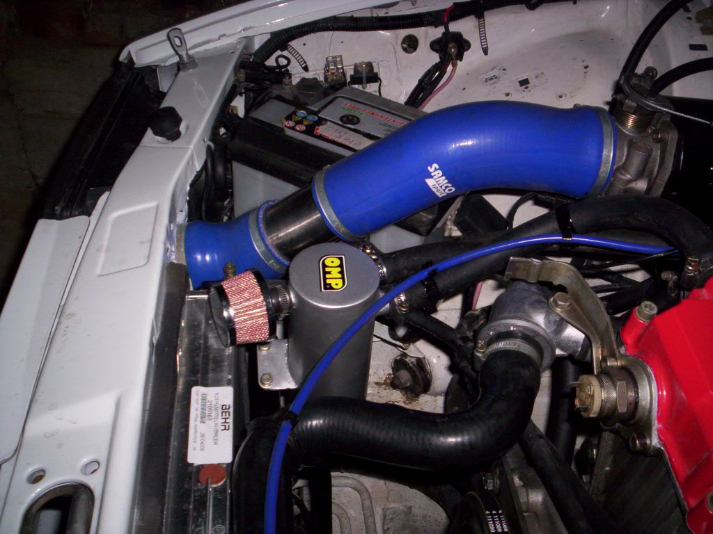

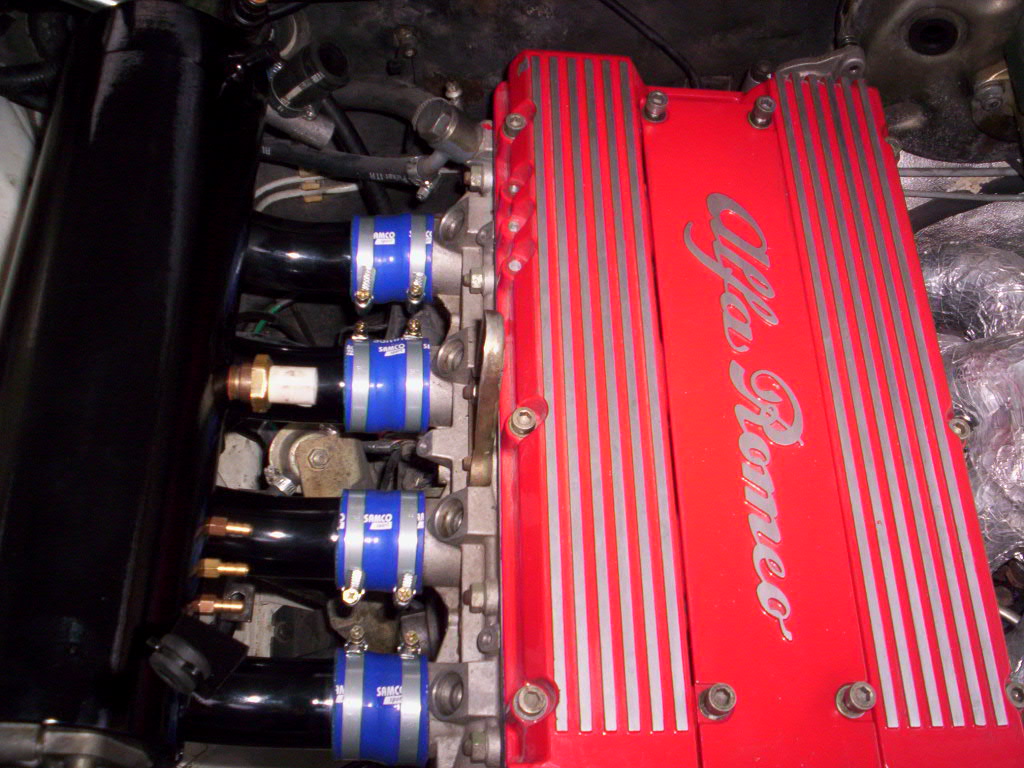

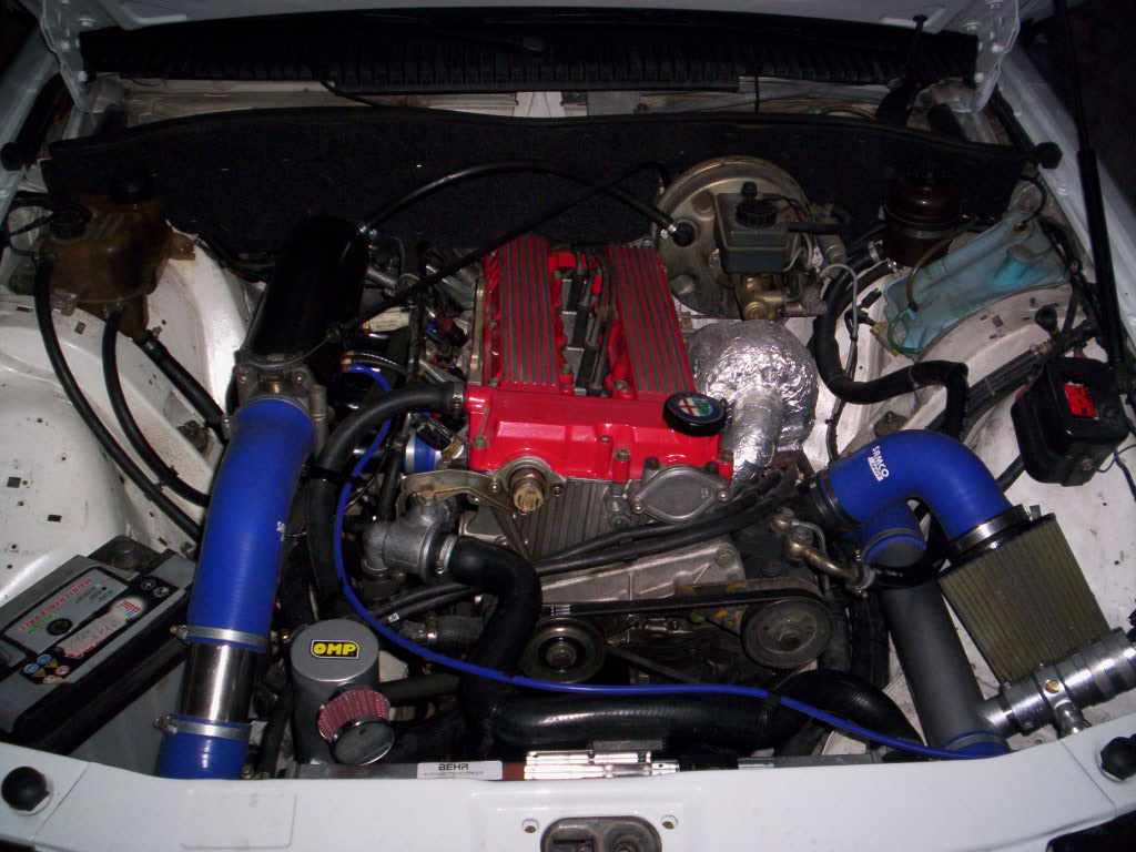

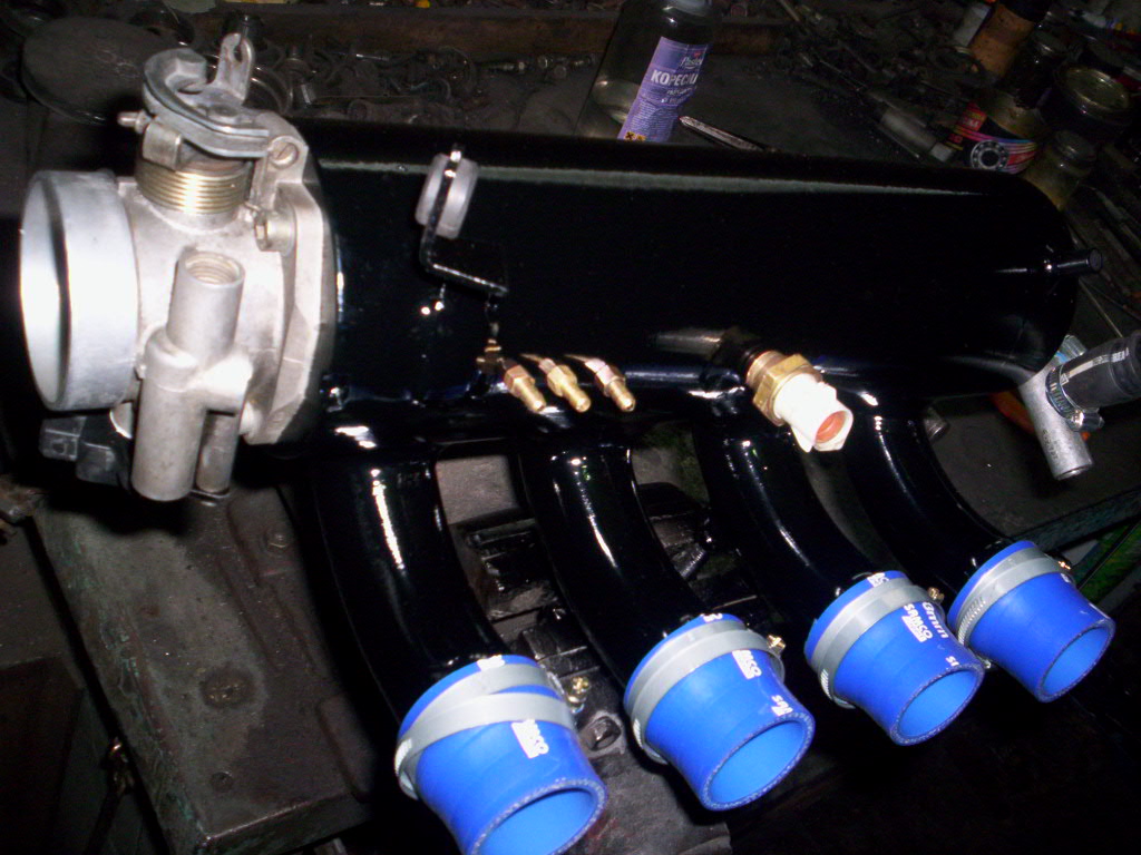

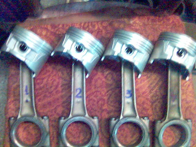

my friends 75 TS have stock internals but 85mm nissan pistons with 7,8 CR .. turbo is t34 from ford cosworth all this running on MS ..
nissan pistons
nissan pistons

Be carefull with silicone hoses and long flexy pipes on the turbo's intake-
I've seen a turbo suck in a coupler once on a VR6+Turbo on high rev/boost ,this was a sad case...
