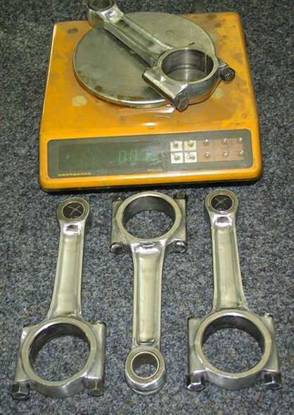

I'm not really a believer in the cryostuff.
But simple things help like rounding all the edges and see there are no sharp corners left. Lighten the small end (some rods have a lump there just to look funny I guess).
Balancing the rods doesn't help the rods themself but the balance of the entire lower end.
I didn't break my stock rods (2.0) yet and the engine sees above 8000 rpm.
