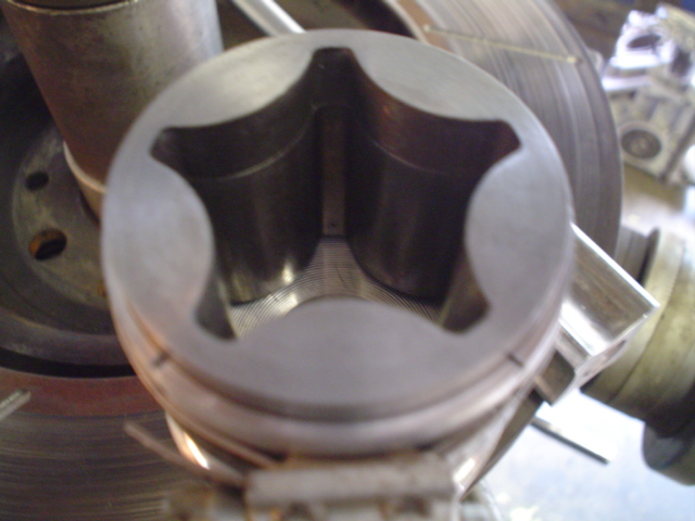

Let me tell you,the interferance fit of the gerotor to shaft is very tight...I destroyed a gerotor trying a puller..then I found out the gerotor and cage are made from a very porous cast iron material..
While machining it on the lathe,clouds of burnt oil coming off the job..

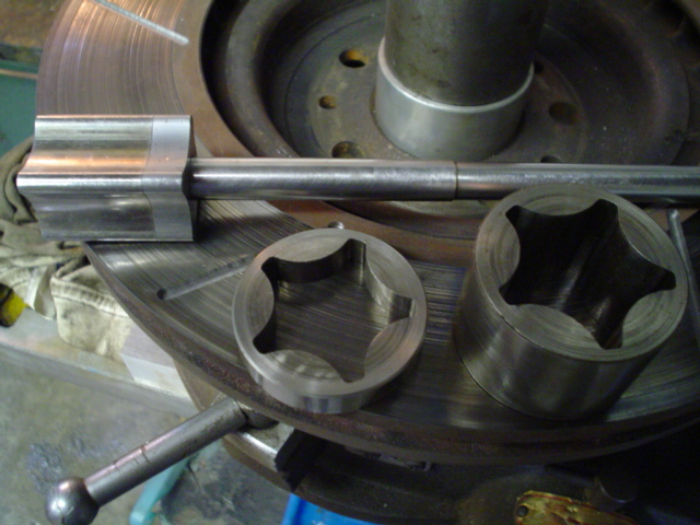

Any how,here a start of the process..
I reckon the additional volume will be about 25%..A lot I know,but its the same I did with the 4cyl pump..
Im not looking at more presure,(its got way enough..)but volume...

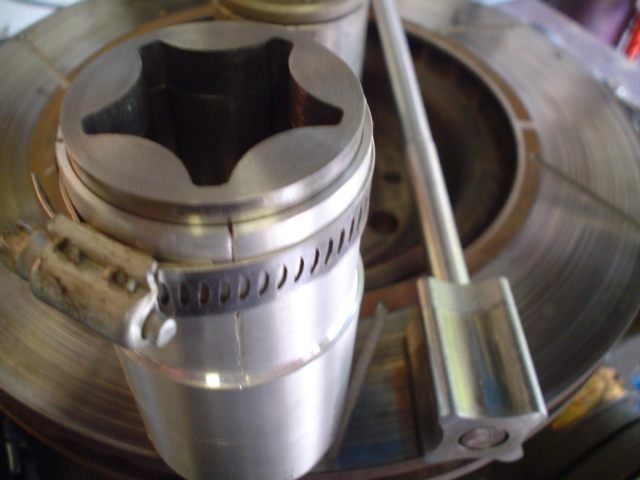

To tie up the two parts,ive machined a housing from ally.I slotted the housing and then clamped both halves within it.Ive trued everything up and will now drill 5x 1mm holes in each of the 5 lobes and stick a cellock pin down each.All this must take place within the jig..

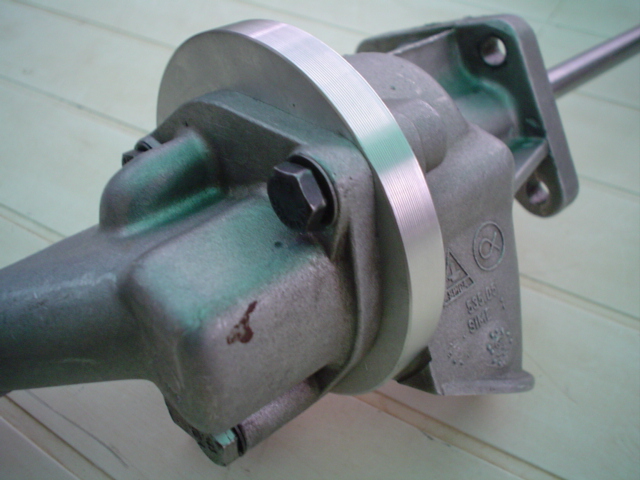

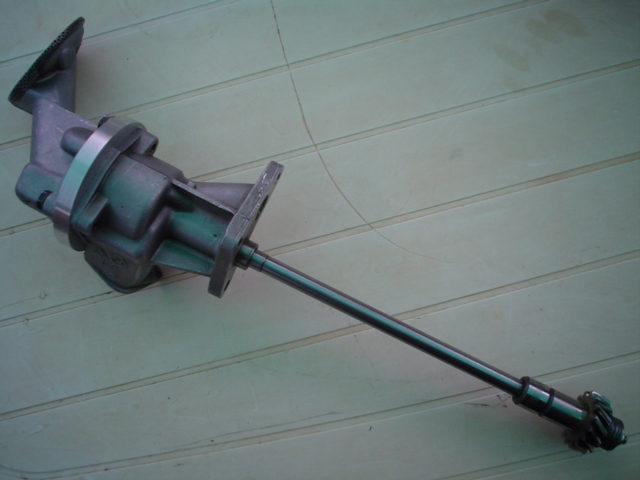

Thought I should at least post a pic of the finnished aricle..If anyone wants to see the insides,ill post...
:idea:
