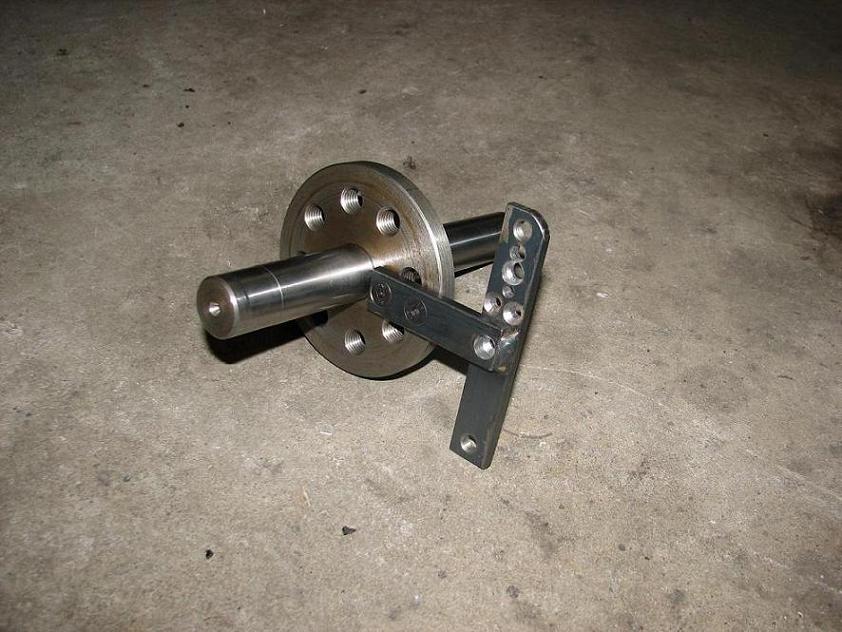

Some of you might have seen this already as I posted it on the other forum. This is a jig my dad made to re-balance the flywheel on my 75 after lightening and without engine balancing. The original flywheel was mounted and the jig balanced to the flywheel. Then the flywheel was lightened, and bolted back on the jig and balanced to 0 balance factor, which returns the flywheel back to original balance.
- F.wheelbalancejig.JPG (90.29 KiB) Viewed 11765 times
Great !
Nice idea, the jig... can it used with a mount for balancing
motorcycle wheels "at home", or only for sending to a balancing-shop?
Very interesting if it could be a "homebalancing" method...
