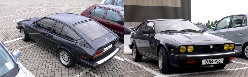

wheel
Exception:
What are the name of those wheels in the picture of car? They look cool. Are they stock or aftermarket? Will such wheels fit on my stock '85?

They are the illustrious Ronal A1 wheels that came as an official option when buying the car. I didn;t have them (as you can see in my avatar they are not on my car back then), but got them off a friend who had a spare set. They are extremely hard to find, but not expensive if you do. Since they are a stock option they fit perfectly. I think they are slightly wider than the original wheels, but you can use the same tires, which makes the tires look a little bit rounder which looks really nice (I think). They're about the best wheels for a GTV6 I think, besides perhaps the Zender ones, which look exaclty like the Ronal's though, perhaps a bit sleeker, but they're even harder to find and not always a perfect fit, and certainly not an original option.

Nice Ronals, 15x7. I had the 4-bolt version on an Alfetta GT. Only wheel I like better is the OZ wheel, also an Alfa part and likewise now hard to find.
