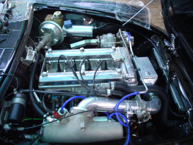

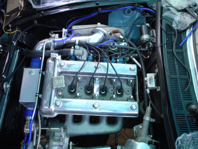

Thought Id post a pic or 2 of the black Spider turbo ..Im almost done with her,needs an exhaust(Monday,Stainless..) and the charge cooler needs to be connected..
Im running the local Dicktator management here(Jim?)..Got to set that up as well...Nothing fancy here,very functional... 8)

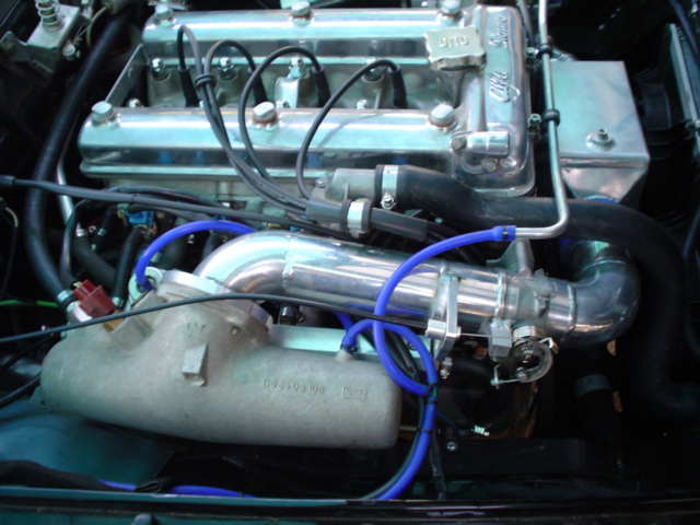

:) very nice work indeed there. and alot of shiny stuff too lol. is there any reasoning why you have positioned the throttle so far forward or is it simply a case of fitting it where it fits (we have all been there).
patzo_3l
Yes Barry, I hear ya, but where's the other two cylinders????????
You got the other 2 cylinders!! v6 wasted spark ! Ill mail you.. :roll:
patzo_3l wrote::) very nice work indeed there. and alot of shiny stuff too lol. is there any reasoning why you have positioned the throttle so far forward or is it simply a case of fitting it where it fits (we have all been there).
patzo_3l
Yes,thars where it fitted ... :wink:
That looks really great Barry. Did you make that exhaust manifold? It's nice.
Hi Greg,I have the exh. manifold cast to a patern I had made,same as for the v6..
This particular one though is from a company here,Alpine Developments,that did the factory Alfetta turbo`s in the 80`s..
Is that a Fiat intake plenum?
What kind of power?

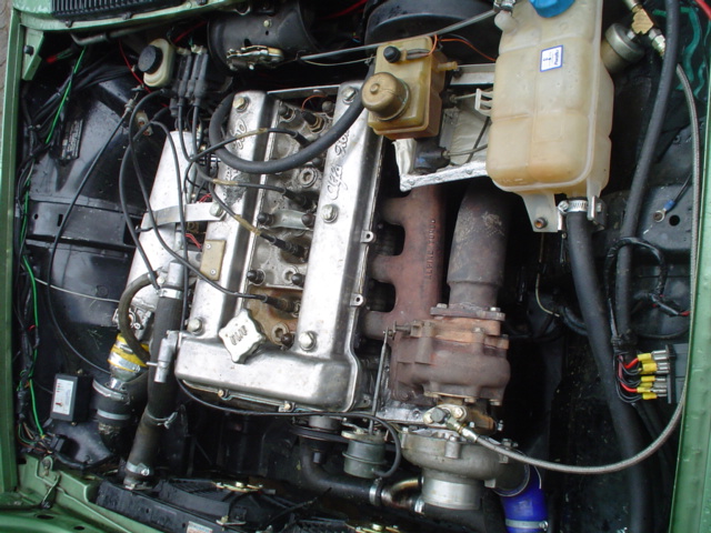

Mats,no,the green car`s intake plenum was a total mess...did nothing for performance..It was homemade by someone..Im putting the same motronic intake onto the green car,this one I want to see 200 wheel hp..Small turbo,full boost by 3000rpm,nice and drivable..
I hate things that make 500hp between 5500 and 6500 only..
The Black spider will see about 150 wheel hp..enough on a spider.. :wink:

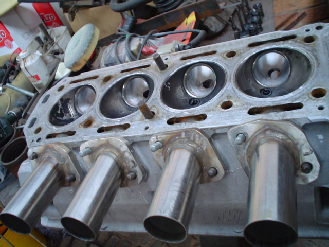

Green cars head..
