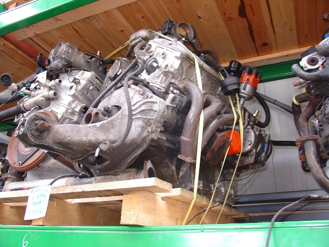

as i am placing gregs supercharger(6 to 7 psi) on to my 3,0 12V engine i was wondering whether the gta rods are a better option.
i bought myself an extra sz engine, but the compression ratio is 10,5/1 standard.
maybe buy some lower compression pistons and ,when necessary,place the GTA rods.
the rods are 84 euro(109$) a piece
the extra engine is okay and has only done some 78.000km, so i don't want to waste money on mods that are not realy necessary!
i also want to use the 164 intake plenum with a chargecooler.
who can give me some advice that can make my engine reliable and powerfull without boosting the cost to astronomical figures!
