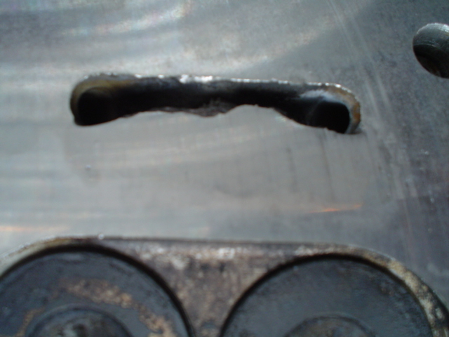

103.4 mm bore..Problems imo...
Id stick to a 100mm bore without welding heads up.This is safe..
If you weld the heads up,102mm bore max.Preferably 4 "(101.6mm)
Id use the headgasket as in the 20l turbo trhead ...
Also beware pistons touching opposite sleeves at bdc.You have to notch the sleeve...

Joolszzz,As soon as you go bigger bore,cr increases..obvious.
The 2.5 head chamber is way too small for a big bore and reasonable cr..At least take it out to euro/us 30l spec.,mo only..
Mmmmm....or run inverted dish pistons....mmmm....
