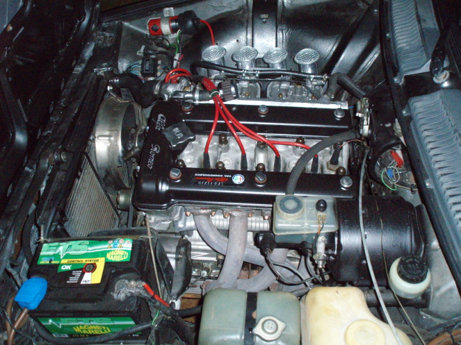

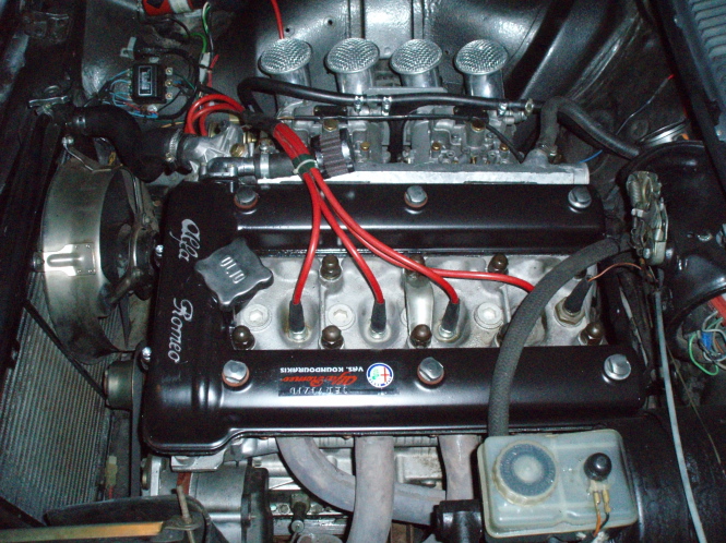

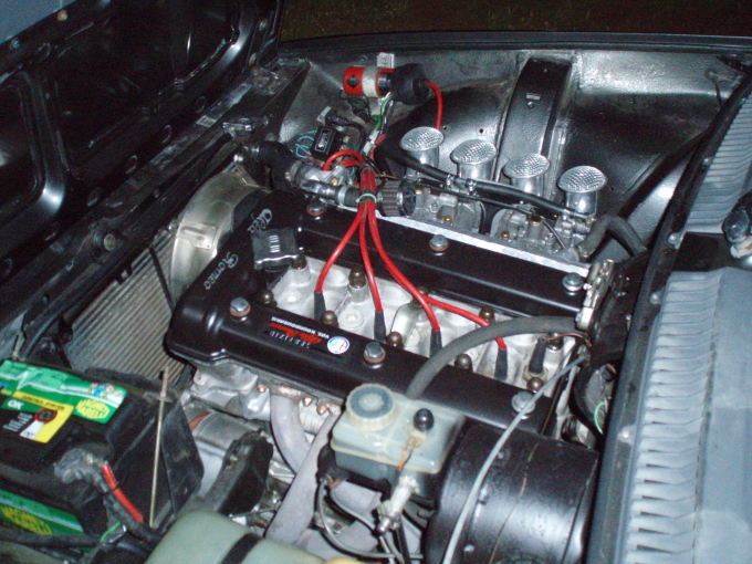

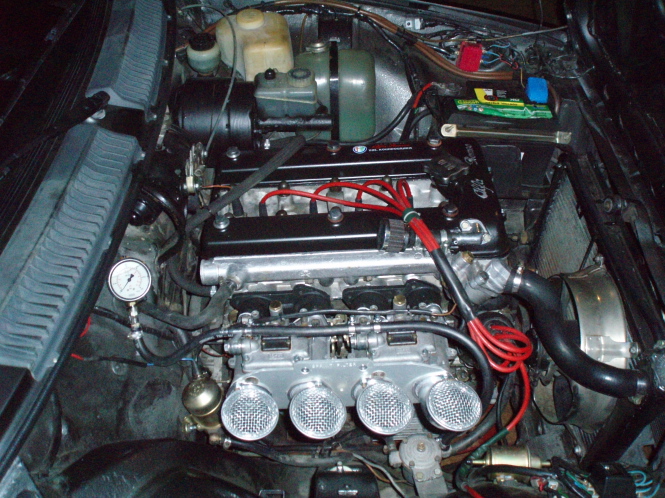

Greetings gentlemen!
I post some pics of my latest seriously OVER THE BUDGET 4cyl engine project!!!
-Dellorto DHLA45D's ('power-jet' from Lotus Esprit 2.2), mitsuba electric fuel pump
-GTA trumpets with alu plate
-Longer aluminium 45mm carb mounts mated to inlet manifold
-Colombo Bariani cams (12mm, 292 duration), Kent valve springs
-Gas flowed, ported and polished head with larger valves and appropriate seats, bronze guides etc (Head was measured at 111cfm)
-10,2:1 Borgo Pistons and head skimmed for about 11:1 CR
-Custom made exhaust manifold, 50mm ID stainless steel exhaust
All by Vassilis Koundourakis (one of the most respected historic Alfa race mechanics in Greece) with the strict supervision of the guru himself Mr. Jim Kartalamakis!! (Many thanks for your patience mate...).
Next step is to gently add about 2.000kms to it and finally put it on the dyno.
My respect to MD, Barry and JK!!(Carbs forever!)

Hi cchan,
i am quite conservative regarding expected horsepower but i will be quite happy with about 160hp at the crank (although there are official Autodelta documents that claim 180hp at the crank with these level of mods).
For wheel hp estimate about 18% loss (as talked about elsewhere in this forum).
Thanks for your comments!
