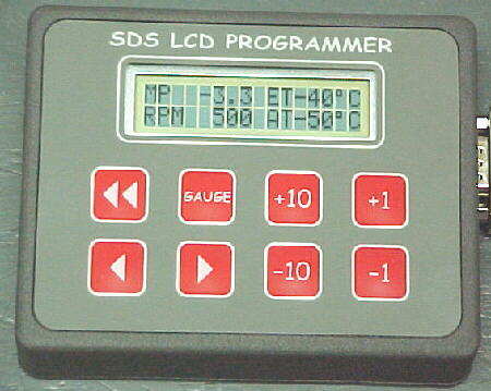

Hi Mats,
The system comes with a programer that logs the data. If it helps, think of it this way, it comes with its own laptop. No need to use another one. I have attached a nice picture for you. This thing has all data, injector duration, manifold pressure, ignition curve, air temps, etc. Whatever you could want to know, it's in there.

Zamani, that's mostly correct. You can change values every 250 rpm. You don't have to enter a value for every possible amount of manifold pressure and rpm. That would take forever!

Zman,Ive worked with SDS before and what Greg says above is absolutely correct and more..
The interpolation between set pints is what is so impressive.Every 250 rpm "jump"is also divided into 256 points and each is automatically assigned a value through the automated interpolation action..The system has come a looooong way from 1990 when the first basic systems were being used on some of the quick Buicks..
The method of using the hand held is the same as the Australian Microtech..
Also brilliant but really geared towards Rotary application.
The hand held can be looked at as a "cottage pane" window.You would scroll up and down,left and right in a specific "window .
Up and down would be your different main components and left to right would be adjustable data within that component.
Greg,the first few SDS systems actually were Laptop or computor driven,the hand held was optional and now I see its the main method of inputting data...

Oh, I see.
Looks to me like it may be a bit difficult to get a grip on if you only look at on cell at a time. Guess you learn after a while though, just like anything else?
Losing the laptop is not an option for me, I'd like to be able to export the data to other applications too.
Greg,
I see. I saw some example maps and I couldn't figure out how it worked. Sounded a bit strange (1 fuel value per RPM) when I first saw the sample maps. I guess you are right and your answer is logical. I'm just so used to the spreadsheet style UI.

I think I understand what you were looking at. They refer to a term called "RPM Fuel" which is the main fuel data you enter. However that's not a hard number that equates to a specific amount of fuel, it varies with manifold pressure. In other words if you increase RPM fuel at 3000 rpm from 100 to 120 it adds a percentage across the whole range of manifold pressures. It's really a no brainer once you start doing it. If you need to alter the amount of fuel adjustment under boost you can do that in a seperate area, but they say for boost levels below 7.5 psi you won't need to. They were right.
