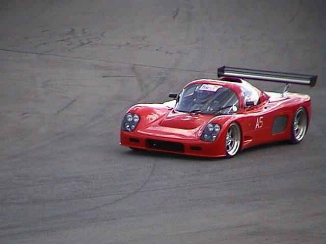

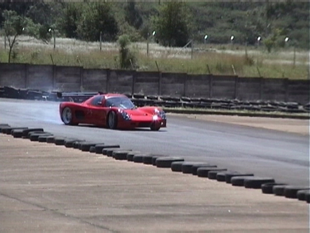

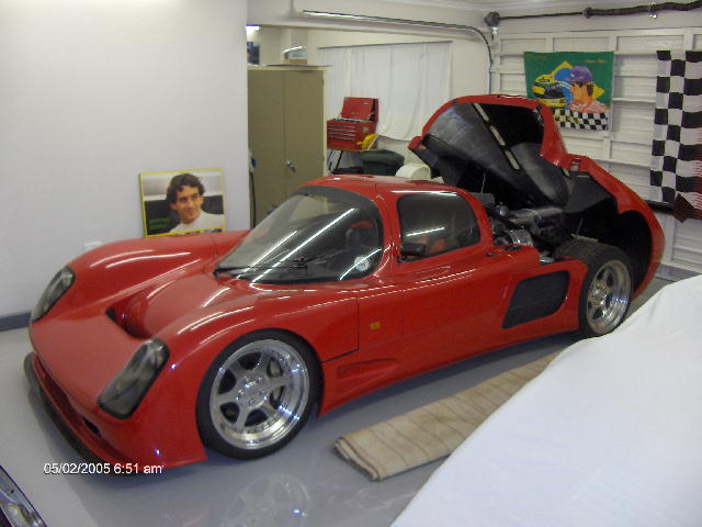

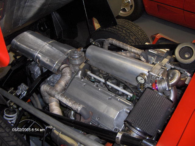

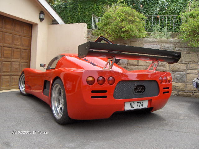

Yes-yes, it's not an Alfa, but its heart is.... And BOY is it ALL Alfa!? I thought that you would all appreciate this;
In 3.2 TT trim, (with stock GTA crank, stock 24 valve rods, stock 93mm 3.0/3.2 pistons and rings), this beast put 620 horses down with about 1.3 BAR - and not thumb-sucking horses either - dyno horses at the wheels - graphed... A testimony to the quality of the Alfa internals...
After 5 years of abuse one of the rods finally let go. Stewy insists that it was the scare the day before that did it... At full boost in 3rd with the throttle stuck wide-open, he spun out and was going backwards - tires lit - with his son in the car with him.... Minor damage... The next day, the rod let go.
I got to drive it with the spare stock 3.0 twin turbo motor with .8 BAR and a mere 485 horses.... The thing is fantastic.
Dr. K. is putting the same Ross 100mm jobbiess in there that Jes and I are using, but I think that he is going to go with a stock crank for 3.45 litres and TTs... We'll see. This time he IS going with ARROW rods! (I would just go with the 100s and keep the GTA crank for 3.7TT - but I dunno. Dawie seems to prefer the 3.45 bore/stroke combo for the TT.)
Here are some pics.
Here are some pics.

Glad you had a good trip. I think you may have some of the engine specs wrong.... i'm not sure, as this may be a different engine from the last time I was in the car.
Dawie and Stuwie talked over the engine spec, and it was (last year) identical to my TT gtv except the Arrow's steel rods, and slightly larger turbo's.
Specs were (then)
3.3 24v
stock 3L crank
Ford Sierra Cosworth RS500 profile cams
Porsche 97mm turbo pistons/rings
Arrow's steel rods
American throttle bodies
extremely large balls needed!
1.1 bar boost
I heard the little end rod journal split open at the top causing the failure, and Arrows sent a replacement asap!
It was pretty mad on the road JJ !! as i'm sure you found out!
But like I said that was the spec when I did a story on the car for TRC mag (i'd be a bit worried about putting 620hp on stock alfa pistons)
As for 3.7TT that could be toooooo much of a good thing. As stuwie probably mentioned, the engine in 3.3 form just became too powerful for the Alfa chassis.
If your gonna go TT, I'd go for 3L crank and 97/100mm pistons at the most, and cheaper! you will need a box up front!!!! don't even think about a t/axle......!

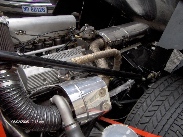

Put your mouth to those Garrett ball bearing blowers and you can spin it with your breath.... Just beautiful.
Yeah, Andrew, no... - no Arrow rods when it broke - it was a stock AR rod that let go... He is only now putting the Arrow rods in the rebuild 3.45. (I had the broken one in my one hand...)
The 3.0 is running the stock pistons - right you are - the 3.3 was running the Porsch (uhhmhondahuhumm) pistons....
The stock units handles the boost well (even shaved down), but he is going forged alli....
Cams were Dawie's "Group 1" cams...
The T-Boddy was just a stock AR piece, slightly modified... I have some close-ups.
Boost was dialed up for the dyno runs
.8 on the 3.0 is correct with a 7200 shift.
He had other rods at some point and was shifting 8K but that was pulled back while I was there.

It did have twm? american individual throttle bodies, with the exact same airbox as in your pic's a while ago...... as when we were speed testing, one of the linkages snapped off a single body and left the car running on 'five'.
Took pics of the broken linkage!
