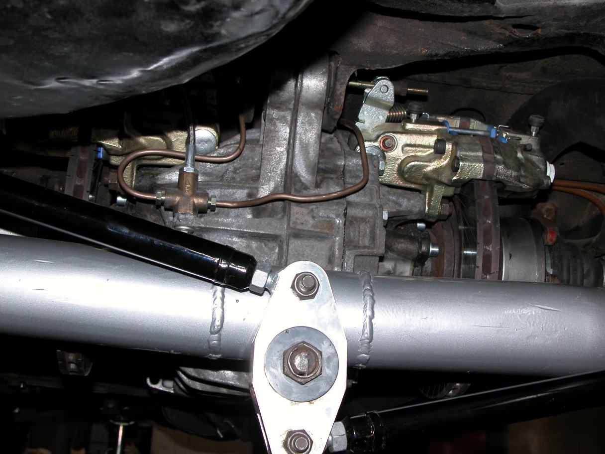

Hi all,
A picture of my 75 Milano race car. I have not done the mod my self, but I guess the pictures shows the idea. Mail me for more pictures. :D

I did cut the tube at the outsides. So I could dail in some toe-in ....
That is an idéa, but it is more difficult to control the exact angles.
You can also give it some toe-in by put a couple of serieous welds on the pipe, it will pull the pipe crooked as it goes cold.
Pretty difficult to control though so practice first. ;)
