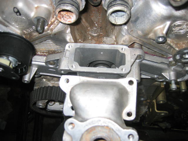

The standard GTV thermostat housing was to be used but it is not simple as on 164 conversion as the bottom of the thermostat housing 'ears ' had to be cut off and rewelded to suit the 166 waterpump.

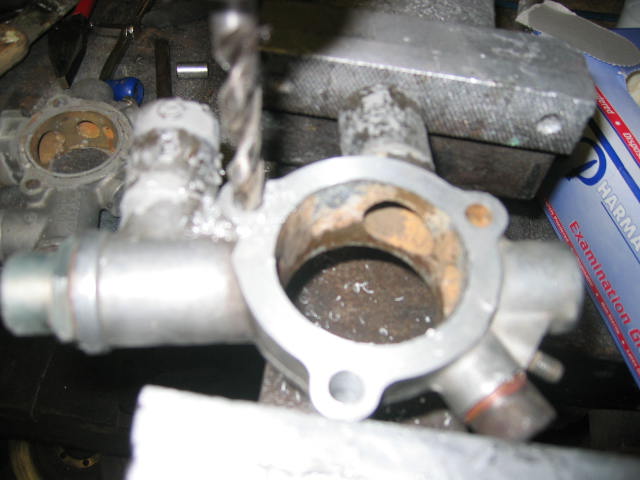

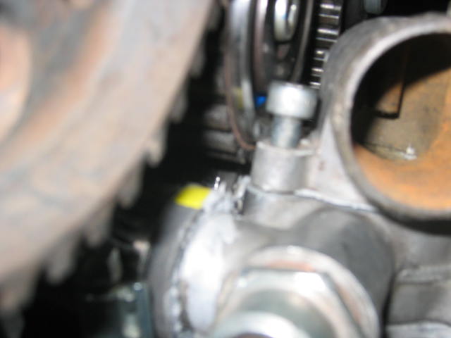

As the waterpump sits closer to the timing belts I had to move the top thermostat housing out by a few mm for clearance even after grinding the sides of it. To move it out I redrilled the 7mm hole to 8.5mm in the centre section as shown and also bench ground it down 2mm. All this to clear the timing by 3mm which is all you need. Cant see it getting closer.
Probably notice there is no thermostat and the bottom housing is blocked with a welch plug.

pic of welch plug
See the grind marks on side of housing
side view

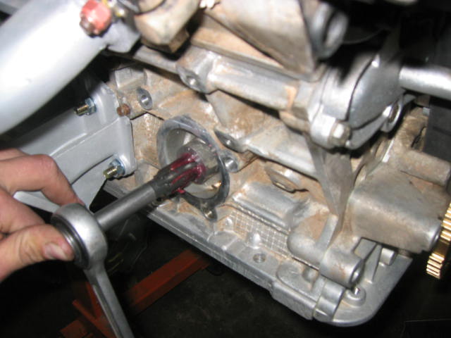

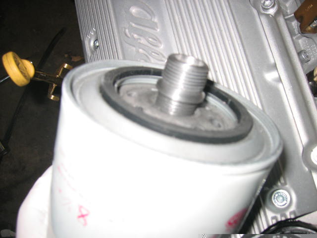

Next was oil filter. I had to make a choice on filters before tapping thread as the GTV and 164 have same pitch thread which I think is 16 &3/8 while the 166 is 1.5pitch. Went with the GTv filter Z96. Must check filter fastens properly againat block and insert does not extend to far inside filter and block it causing it to explode on startu ( been there and done it).
Who needs a drill press! Sometimes got to make do.
Tap in with a grease filled cloth inside to catch any fillings.
Insert

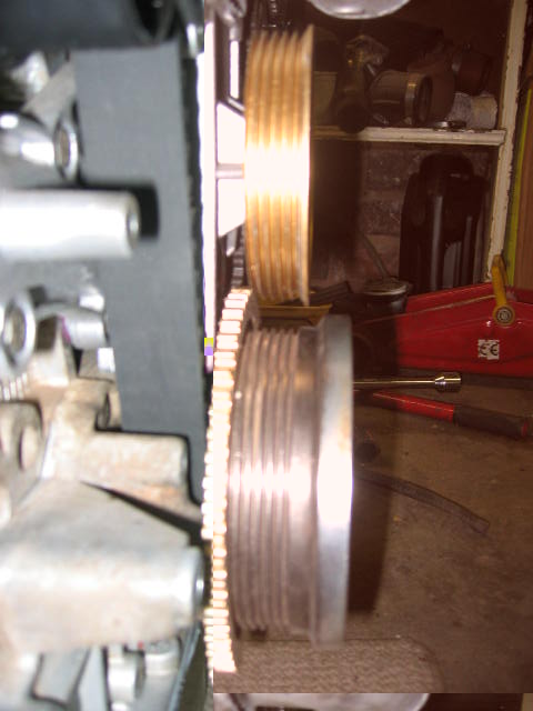

A 60-2 pickup sensor is used but as soon as you press the ring onto the pulley it either touches the cam belt or waterpump pully so both ahd to be machined. The pickup only needs a 3mm area so i was well within limits.
