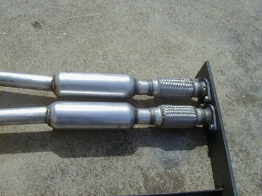

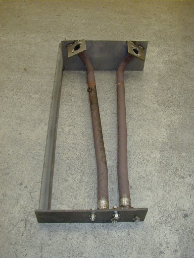

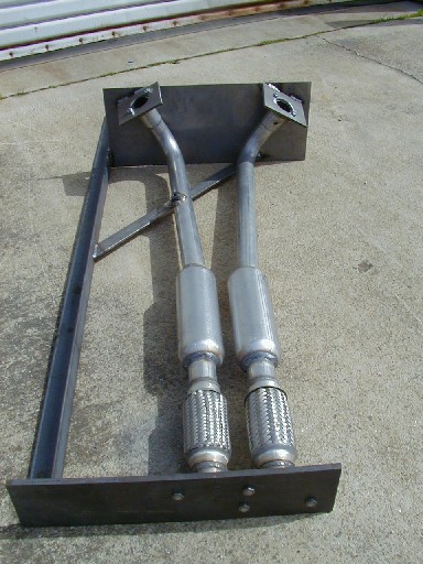

Well, my euro pipe replacement is taking shape.
Have a look at the attached pics.
I made a jig from the old pipes so that I wouldn't have to let exhaust shop monkeys touch my darling. Of course, the jig also lets me replicate these for anyone who might be interested...
The sections upstream of the flex joints are glass packs. The rear couplings are a great way to go for easy fit and removal. If you've got U-clamps, life can be misery.
Can't tell you if they sound good or not yet. My aim is to take away the cheap-sounding high frequency noise that euro-pipes give you. My current set up has stock middle and rear sections.

Vinny,
Sorry to hear about your misfortune.
Don't know the gage, but the dia is 1.75, I believe. The glass packs are 2". Sourced them (and the flex hose) on the internet. Pipes were mandrel-bent locally. Flanges are std 2" at the rear. I'll never use u-bolts again! Flanges at the manifold end are still to be decided - the local weld shop cut up my euro pipes and used the old flanges. I was really steamed about that. I think I will grind them off and try to use 2" flanges or go custom. The O2 sensor is a purchased weld-on bung; tapping wouldn't work so well.
2 months ago, I was making great progress on this system. Not any more though. Got v busy with other things. Plus I'm kind of frustrated with my Alfa these days. Makes it harder to administer TLC.
I will get back to this in the coming month or so. When I know it works and fits, I'll sell it for a lot less than equivalent CSC, Ansa or IAP products.
Oh, missed a question: it's not that hard, just a pain in the arse really.
