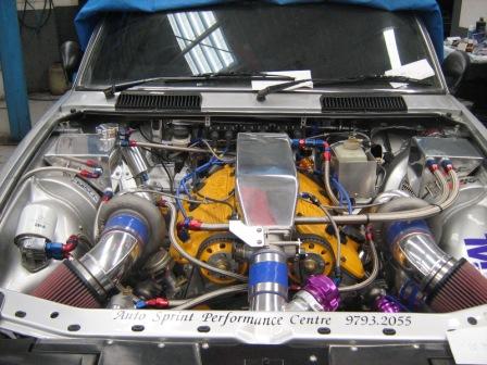

- TT and plenum all looking great!

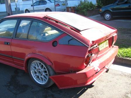

- my car really banged up- no idea what Im goin to do about it....

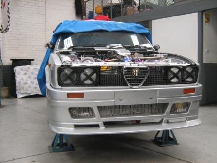

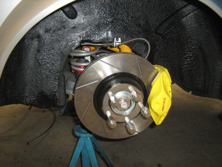

- 166 front brakes on alfetta sedan

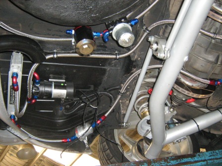

- surge tank setup to go with tank in the boot!
- cars 011.jpg (55.92 KiB) Viewed 11651 times

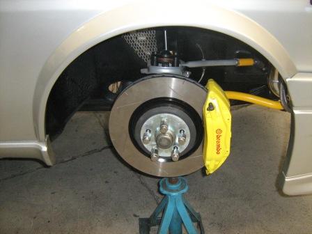

- 75 front brakes on rear

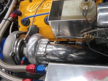

2 Garrett GT30 (maybe 35) turbos
! That's not mucking about!
Maybe a big bore engine to need 2 turbos that would be quoted at 500hp each, as a minimum.
Loved the front brakes on the back

How did your baby wind up with that 'injury' though ? Man it reminds me so much of when I was rammed up the rear by a bus.

Sorry for the absence! May have landed a new job, and busy doing endorsements- Greg, Barry and Matt D if you're about (email u soon), Pac750xl, Chieftain, 310 and good old partenavia- good to get some turbine stuff on, but Fernando- it wasn't far off a bus- It's a grey area at the moment- I don't want to chat about it until it's sorted. Not driving at the time though. I may pull the engine and have it rebuilt for sale with the diff to pay for repairs. Anyone interested feel free to contact. I can't bear to let it go altogether
The Alfetta GT is still as gorgeous as always- some probs with the donk running massive boost and flow levels. Nothing you wouldn't expect from 300rwhp, so PK had it Beninca-d! Rods and pistons bring the comp up to 7.6;1- no typing error, so it will be punchier, and stiil deal with massive boost. The box is a TS box w shimmed diff for about 65%, vented rear discs, full RS w watts, and the box cooler setup, w a bolt in cage for track use. Fab said they;ll rev it until it stops making power. I reckon just past 7 with the mildish cams in it. This used to spin them through third.
Fab's alfetta sedan runs a GPa straight cut (ex bond/jones). He thinks the box will live but not the diff. We will see! Plan is to substitute Commodore front 6sp box and diff into DeDion post failure. The turbos, I think, are GT30s, but they're not off the shelf- he's had them built with smaller turbine housing and more suitable wheels. 3.0 with massive headwork- custom cams, big valves, running 7.6:1 too from memory, or 7.8... custom alloy rods, and you can see the coil setup. Unfortunately didn't get the best shots of the radiator and I/C- in a hurry. But you might just be able to make out the screamer pipes off the wastegates. Fab just goes for the craziest thing he can haha. Bits of RS stuff in it. He wants to try it on the track for fun. It'll be interesting! I think he may end up dragging it. Either path you take with it ends up in $$$$ when the engine is like this one. My pick is close to 500rwhp. Fab says he wants 700. It's got all the bits in it, and I don't know all of the details, but I don't know how possible it is. One thing's for sure, is Fab builds every engine to rev- he doesn't muck around with reciprocating bits. With the boost/total airflow combination and rpm capability (8000) it will be a big enough number to break things!
As usual, everything he touches is fit to be served up on a platter. No pics will do justice to how good this engine bay looks.
