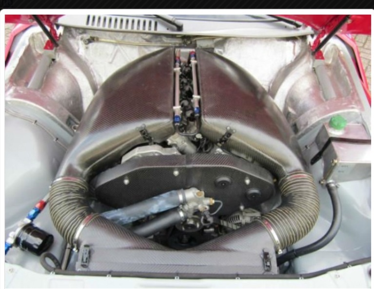

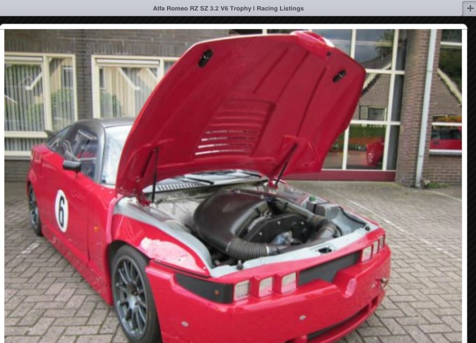

Bit of an old thread but this has got to be the best intake manifold design seen on a transaxle . This car does run a new modern 3.2 gta motor . I also saw the price tag of the sale at 75 000 Euro . :shock:
Re: Inlet Manifold Design
That price is not over the top :wink: ... the entire car is done as beautiful as the engine. Almost everything on the car is specially build. Even the bodyparts are all lightweight carbonfibre. Most extreme race SZ in the world.
My absolute favourite SZ next to Marc's.. 8) Just needs road registration and some lights and stuff to make it perfect. :twisted:

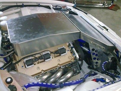

Another airbox on a 75 . Also very neat .
Looks heavy and possibly not tight (as in you need an air filter).
gtv-racer
Posts: 256
Joined: Tue May 12, 2009 12:02 pm
Post by gtv-racer »
Think it has induvidials and those guys mostly don't use filters.
Posts: 944
Post by 75evo »
Not using filters is a really bad idea. What if some one goes off track, kicks up a lot of dirt, and you run through the cloud of dirt and dust. Imagine silica in your cylinders scraping the liner wall.
Yeah, internal sandblasting of the piston, head, valves et al. :?
