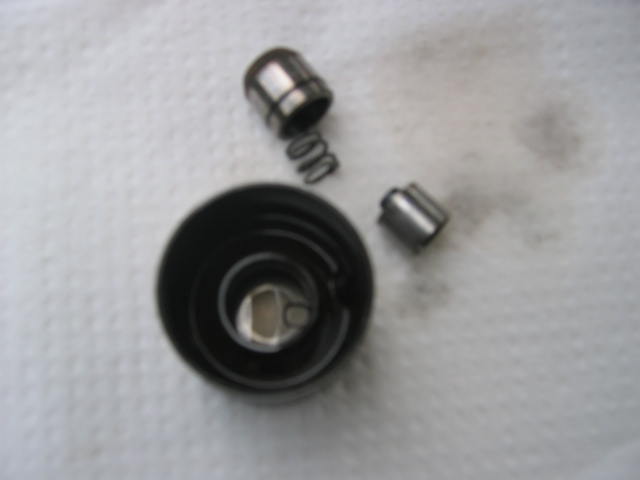

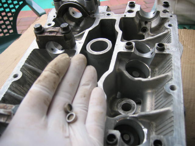

No these are recut . Some old pics of collapsing lifter and shims from my 3.7. You would not do this if you were a works production team as you would have full solids . But hey they are searching for milliseconds.

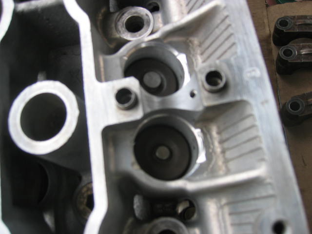

You can see the shim on top of valve. Here is a pic of shim.

Kevin, thanks for the insight. If/when I do this I'll likely do what you did with your 3.7. I had also gone and found those picture last night. Are the shims kind of a cup shape? That's how I'm seeing it when the one is sitting on top of the valve. But in your hand they don't look that way.

Shims are cup shape. There are a few of shaps who make shims here. True , your hand will ache for atleast a week.
