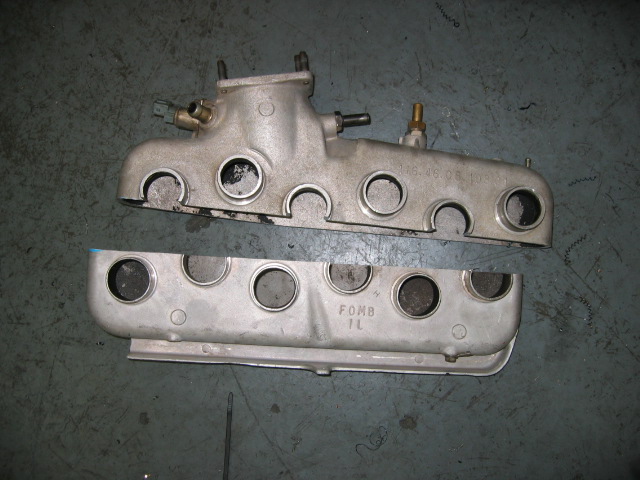

After seen the superb hand made plennums on Barry's bigbore engines and JJ's(Dawie) I have made larger plennum from two 2.5 GTV plennums cut in half and seam welded up. It does not unfortunatey have the same volumes as Barry's and Dawies but it is better than before for this 3.2 GTA engine .
A few pics to follow.

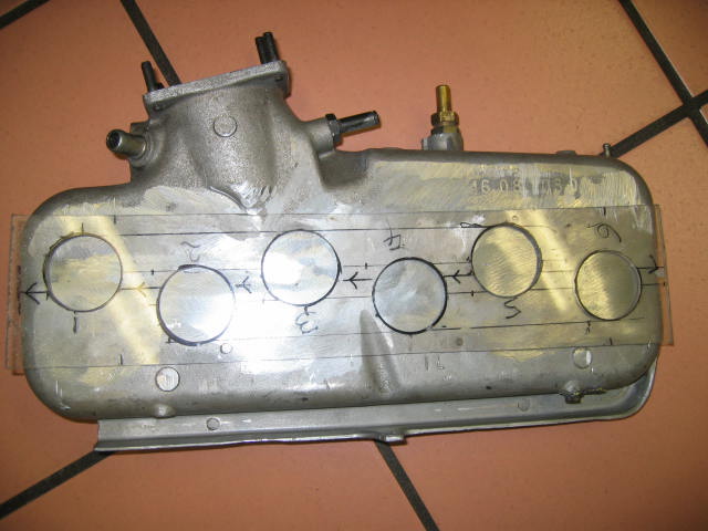

pic 2
pic3 seam weld V joint
pic4 cut holes in template of runners.
Oops sorry about that. Pic 5 the 3.2 GTA engine intake runners
pic 6 need to measure the distance of runners from front to back and line up with new plennum so the hood can close. As the engine sits at angle you cant assume it will be square to the hood. Can touch.
