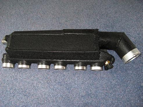

- Hard to make out from this shot....Behr cooler core grafted into 164 plenum.
- cooler2.JPG (54.05 KiB) Viewed 14384 times

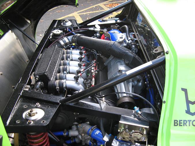

- Complete working installation. Water/meth injection not actually used in anger...a massive 5psi really didn't warrant it.....may well be needing it this time round though. Either that, or I spin the blower quick enough until it is needed.....
- blower 2 web.jpg (84.51 KiB) Viewed 14578 times

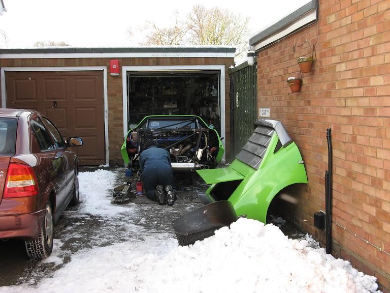

Clutch sorted. My fault really - I should have paid more attention when assembling it TBH. Given I was using mix & match parts, can only blame myself. Anyway, it was due to the centre boss of the friction plate being bigger OD than the ID of the pressure plate fingers and them being very close together (only 6mm clearance)....harder I pressed the pedal, harder I pushed the friction plate against the flywheel. Clearly, the first time I tried it when the linkage fouled, it was effectively limiting travel to exactly the right point for it to work. I could have solved it by limiting pedal travel had I realised...but I don't like the idea of the parts being able to interfere like that, so for now, I put a stock Valeo plate in with the Helix HD cover plate. I'll get the 6 puck friction plate turned down so it clears and think about fitting it if it's needed.
Just need the snow to melt now.....
Lump on the lower front right is the numberplate - does look as if it has thickness, but I think that's an illusion
- Chilly.....must be nuts.
