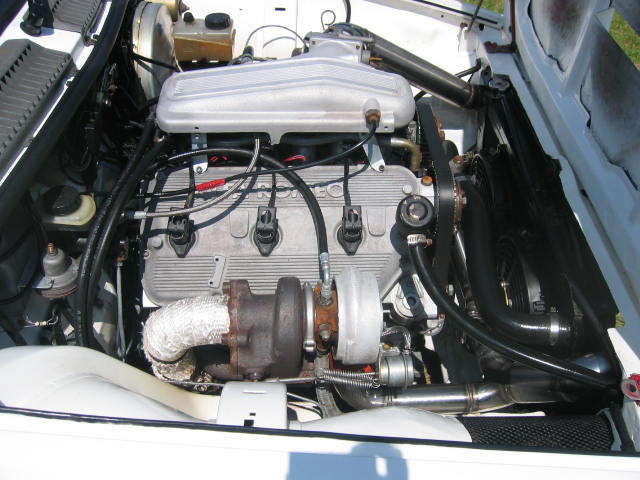

Hey all, well i'm may be going the twin turbo route in the not too distant future. The single setup is just too retrictive i think for what i want.
Anyone have any good turbo sizes for around 300-350 HP.?
I'm thinking of running twin plenum chambers with seperate throttle bodies..shouldnt be too much work changing it over i think... :roll:

Making it TT is very much work i guess. You would add another turbo, dowmpipe, oil feed, oil drain and a lot of other piping and stuff. ot to mention that you would need new manifolds also.
Changing to a bigger single would be the easier and cheaper option. You would also be back on the street sooner. :wink:

Hey Evo, well i'm thinking about going that route, but maybe i'll stick with what i have...dunno, think i'm just getting bored...maybe i should do another car, i'm not sure.
I'm going to rebuild the turbo i have now to what Jim recommended, will have 300hp easily then. But i thought with the 2 turbos i could get them second hand to start with, i do all the exhaust and manifold work, pipe work myself, plenum chamber fitment..i could do it easily..but yeah will still cost me around $2k..anyway its something different for me to do, its my only hobby after all i suppose. :roll:

garth, youre forgetting something very restrictive - GEARBOX :?: Youre totally wasting your time sadly. Between myself , Frank(white TT) and Dougie (3.7) there is a pile of 15 scrap gearboxes. Its not a one off break.

For fucks sake, instead of asking a bunch of guys who run na cars, why don't you go ask the turbo toyo guys about 1JZ/2JZ turbo selections?
I've been in a turbo liberty with the 3l flat six in it and a big f-off garret single - no lag, just makes stupid power instantly...
Just put a bigger single on it, no re-working the manifolds, minimal fucking around, just fit it, tune it and drive it till it breaks.

Garth, how much work would it be to replace the turbine flange with a T3 one?
Me and a mate put an external gate Garrett GT30 (.64 AR turbine housing from memory) on his injected 2.6 Sigma.
Turbo response is very impressive.
The car still uses a reprogrammed early Magna computer and tiny AFM, and the dyno operator was a complete dud (he couldn't even scale the graph properly, so we didn't see the top of the curve and their logo was all over the graph any way), so outright power isn't known, but it should smash 200RWKW with ease when we finish fitting the EMS 4424 and get it tuned.

Damn you guys are right you know...Ben, that sounds like an idea to say the least..
Kevin, yes your right too about the gear box's...hmmmm(damn)
Duk-Dont those Sigmas fly..? And your mate has a boosted one! :D
To put a T3 flange on would be a walk in the park..also my manifold has been extremly reliable, so scrapping it would be a shame indeed.
But like the T3 idea Duk...damn gonna pull turbo off this weekend and have it rebuilt...! 8)
Ok, tell you guys what...will rebuild my snail soon, and will keep you guys informed!!!
If i'm not happy with that, then twins it is, 12 psi with meth inj and leave it at that. But Kevin has me scared about gear boxs now!!! :cry:

GarthW wrote: If i'm not happy with that, then twins it is, 12 psi with meth inj and leave it at that. But Kevin has me scared about gear boxs now!!! :cry:
No point in going twins, lets face it. The first thing Supra guys do is put on a big single. so do most skyline guys...
Found the figures - the liberty makes 317kw at 14psi... running out of fuel because of a dead fuel pump... single Garrett GT40 with a 1.06 exhaust housing. There's plenty left in it with a new pump and some tuning.

Ben-yeah they go single because there straight six engines...a V6 is simply better suited to a twin i think.

GarthW wrote: Ben-yeah they go single because there straight six engines...a V6 is simply better suited to a twin i think.
Nice pis mate, very nice fabrication. 8)
Ok, thanks for the help y'all. I'm gonna keep single configuration, and if that dont do it, i'm going japanese, nuff said...i want big power lol.
Think i may be well wasting my time with old alfas...
They go a single because a good modern single is very responsive, and a darn sight cheaper than buying two decent smaller turbos...

Yeah Ben true. Also the reason i went single in the first place was because i wanted less weight in the front end,
less water consumption, and oil...
Think i'll do it up abit more, and simply enjoy it. 8)
