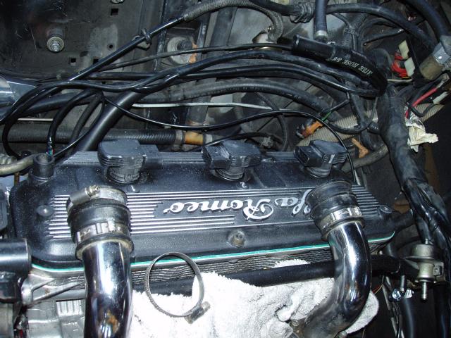

have you given up on the rb30 ecu idea?
not much help as i dont know what coils these are, but it has been done successfully.

Kinda looks like VW/Audi items... these are quite narrow and the length is not too bad either.

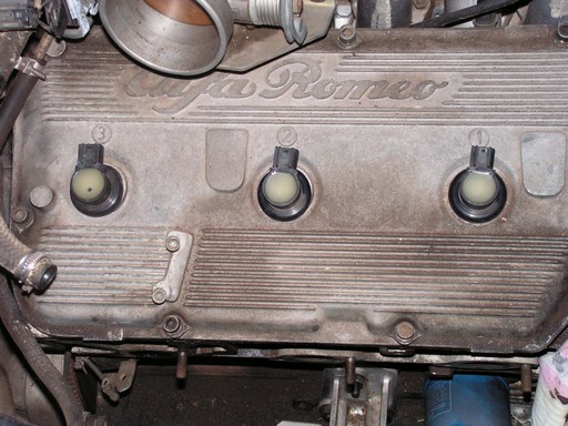

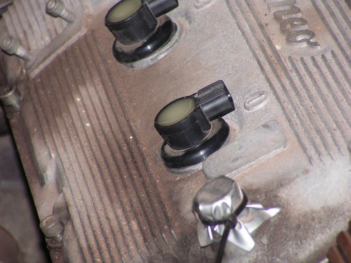

I thought I'd add that Yamaha R6 coils fit quite nicely down the spark plug tubes in the 12 valve. The length is perfect but there is a difference in the diameter of the top of the coil (27mm) and the spark plug tube (33mm), so bushes would need to be made so that the coils locate properly at the top and seal well.
Something to note about bike coils is that lots of them use CDI (Capacitive Discharge Ignition) and these coils won't last with conventional transistor switched ignition systems. From what I found on the 'net, 2006 onwards R6's (and probably R1's) use transistor ignition systems (emissions based stuff, apparently CDI systems struggle to ignite lean mixtures). I scored 8 of ebay for about $80US.
A huge plus is being able to buy the plugs and pins (Denso) brand new for a good price.
