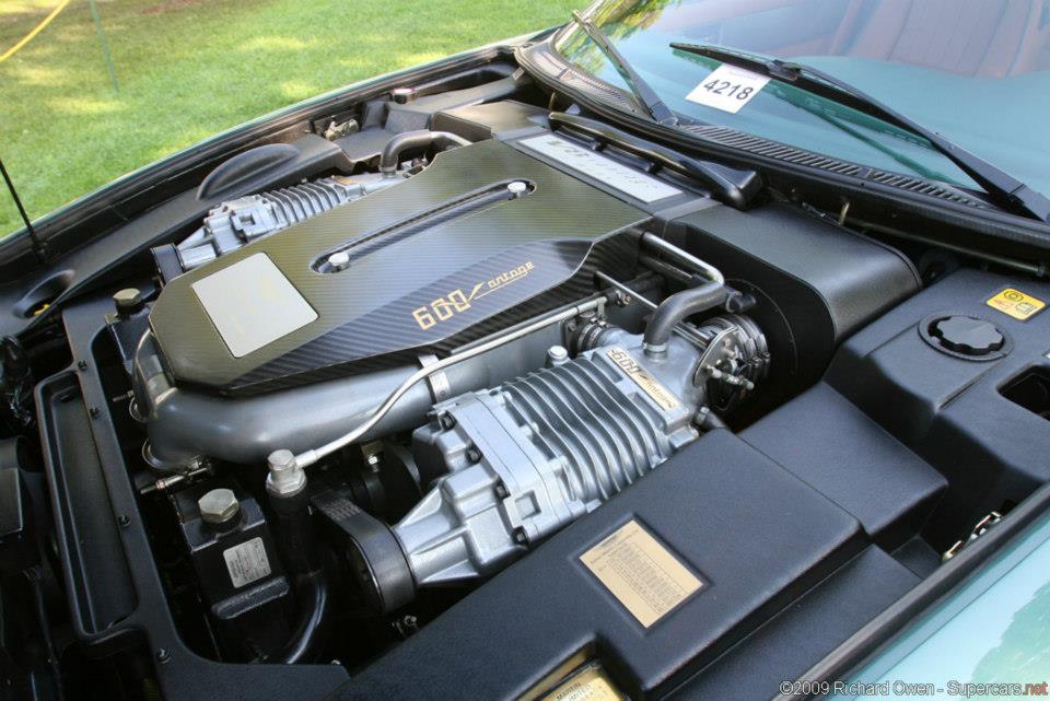

The m62 is what Greg Gordon based his kit on but if you more than be a little daring and use 2 m45's ;) one for each bank like Aston Martin did. Looks pretty cool too

Use 2 M45. Kinda like a down sized Aston Martin. :P :P :P :P

I do believe twin superchargers would sap a fair amount of Engine power but the boost per cylinder will definitely jump! :oops: :D :D
I think the plumbing for a twin supercharger kit would be pretty intense too!
Yeah i saw some 320 Superchargers that also look much more compact and 'superchargery'
Im definitely going to look into this more.
And that Aston idea certainly has some eyecandy bonuses! :roll:
