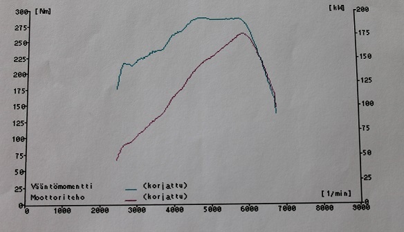

I have 3.0 24V engine in my 75 with Megasquirt 3 and it "dies" after 6000rpm. Do you have any suggestions, what can cause this kind of problem?
Only modifications are: MS3, 45mm inlet pipes, airfilter and 2.5" exhaust (original manifolds)
Here is dyno results. 239hp@5900rpm / 290nm@4810rpm.

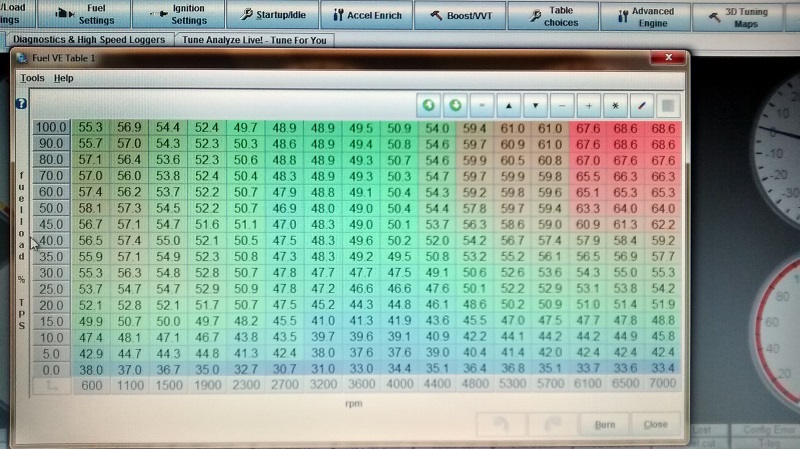

Yes, thats a bit obvious but that is main reason for that problem. Soft limiter has set 750rpm before hard limiter (6800rpm) and i dont know why... I set it in 100rpm before dyno, but maybe i forget to save the file or something.
Here is my fuel and spark tables, if somebody needs :)

I've also set rpm limits quite cautiously for the 24v, similar to yourself. Soft set at 6900 pulling 13 degrees timing out, hard at 7000. This is just to get a slightly less abrupt "stop" as the motor hits that rpm in first quicker than the tachometer needle can sweep round. For info the factory 164's have a 7200 rpm limiter, and other sources state a good condition 24v should be OK up to 7800, so we are both comparatively safe with our lower limits.
Here's my fuel and spark tables for info, ignore that the actual numbers differ as our set ups are different, but the shape and slopes ought to be similar. As an observation, I note that your spark table is flat across load, whereas you could add progressively more advance at lower map values for better drive-ability. Our numbers at 100 MAP are pretty similar though, i.e. normally aspirated wide open throttle :-)

I think your fuell table is a strange and your spark table also. It looks like the fuell table compensate's the bad spark table. They just don't make's any sence . not trying to be a bitch :oops:
they should look a more like SteveR's one.
And once again post a log and a tune and we might can help you. All we are now doing is guessing....
