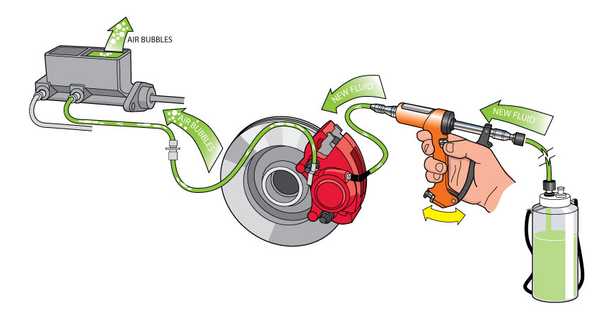

I agree with Kev's suggestions. Could be one of the pistons is binding. Won't hurt to cleanup up the pistons. Then check the rear caliper clearances with a feeler gauge and adjust as needed. Check that the hand brake isn't causing one of the rear pistons to bind.
Buy a reverse bleeder kit. It will save you A LOT of time AND brake fluid.
Just open all the bleed screw and let all the fluids drain out over night.
Then start reverse bleeding
http://www.brakebleeder.com/wp-content/ ... iagram.jpg
You can make a reverse bleeder kit with an oil can spray and cheap hoses.
I literally bled my 164 Super's clutch cylinder and master cylinder in 10 seconds. I see people on 164 forums saying they've pumped and pressure bled for days and still end up with low pedal pressure. Reverse bleeding is the way to go.
