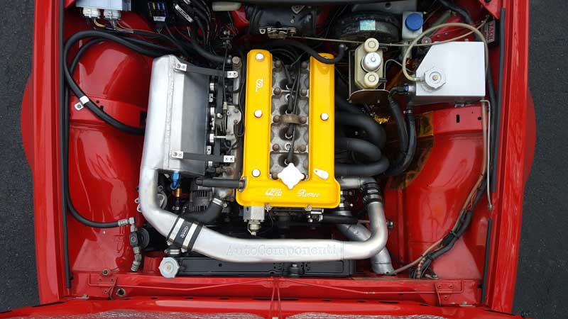

The Nord turbo has about 50K turbo miles and while it is still going strong I was offered a 155 TS head for a price I could not refuse so it got me thinking of what to do.
While the V6 sound is incomparable, I think I will stick with the TS for its lighter weight and less complexity. I already have the prepped lower end with a prepared crank and H-beam Carrillos. Steck will massage the head, we will keep the VVT, which when added to the Nord added 60 lb/ft WTQ under 4000 RPM and 20 BHP up top.
That will leave me with the following to sell off:
Steck prepared Nord head with custom cams and VVT intake
tubular exhaust manifold with v-band
Garrett GT3071R turbo and custom 3" oval down pipe
TiAL 38mm external wastegate v-band
Coolant plumbing and overflow tank for turbo
SPICA intake (itb's converted to bosch injectors)
Water to air intercooler and crossover pipe
Electromotive TEC 3R ECU and custom wiring harness
Idle Air Control motor and plumbing
Basically all you need is a bottom end, an exhaust starting from the downpipe and a few hours to get 300 WHP in a Alfetta/GTV6/Milano/75
Know any one interested in a project?
