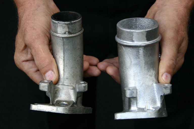

Posts: 69
Location: massachusetts
Post by Jose I »
I don't understand what he means by flatter back valve ,is he saying that if I modify my vales to look like the one on the right it will flow better.
I would realt like to know I'm inthe middle of porting & polishing my heads (50mm runners)

You KNOW it must be the same shape as the 3liter!The ports are the same shape, same offset. Size is a different issue.
Hose1: 50mm runners is TOO big!
TS Turbo: you can have a flat-back AND concave (face) at the same time.
Arghhhh!!! 50mm is too big?! You should have told me that earlier.

Here's a pic you guys have seen them before they are 50mm
on top then taper down to 45mm
Drive'm Hard
I should get mine next week. Well whatever, I'm just going to throw it in there. And did you get the plenum too? I'm getting the whole set. But it's the stock plenum with modified stubs to fit the 50mm runners.

the runners won't fit without the plenum
Drive'm Hard
Zamani, them pair of pants come only in two sizes right now, too small and huge. Ideally you'd want the ~50mm on top, ending at ~38mm at the bottom. You should see what serious engine simulation programs have to say about it! I'm sorry I was too late with this.
