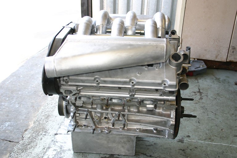

What would drive a man to such insanity....? :D I mean, 350 horses in a Milano...!

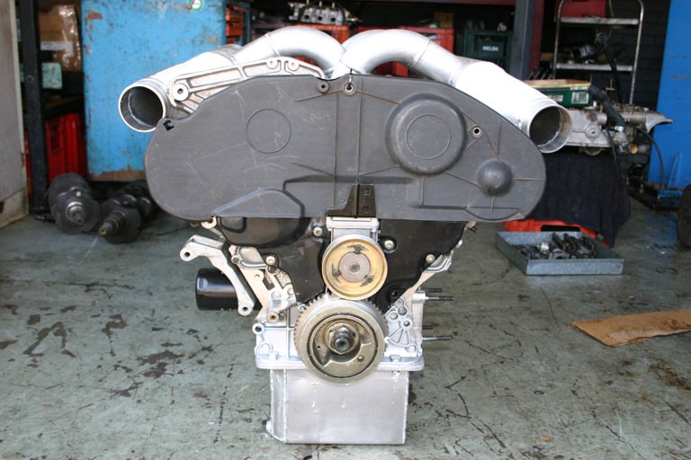

Well,This is a varient of the intakes for the 24v throttle bodies-Good work Dawie de Villiers!!
I believe these are for 2 engines destined for the usa for 2 75 milano`s
John van Reenen, let us know how these work! I think they could sound awesome!!

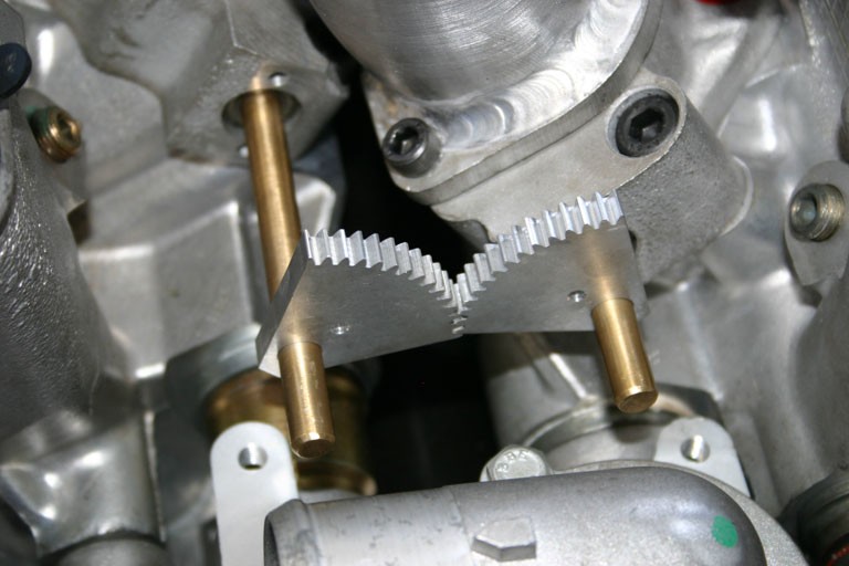

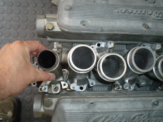

Here is a close-up of the gear-driven link between the two sets of T-bodies - much better than the Jenvey setup IMHO... The links between 6 detached units is so flimsy compared to the single brass shaft that connects three to a side....

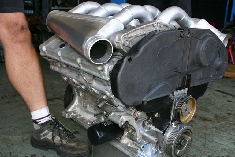

Thanks for the giude to posting pics.Got it figured now.The leg in the picture belongs to yours truly.Your brother was at Dawies to take the pictures and he wanted a shoe as reference...Cant wait for the motor to run in Dawies car to set up the engine management.

Sexy Legs Baz ! :lol:

junglejustice wrote:What would drive a man to such insanity....? :D I mean, 350 horses in a Milano...!
OR how about changing the plugs on this monster !! :cry:

Nice job..Very NICE job!
I would have put some rubber joints on the plenum to the runners themself, but hey that me.

6 Throttle Bopdies;
Post by junglejustice »
We still may do some flex connections to the plenums from the runners, but we wanted to get the fit done first!
It will make changing plugs easier, but we'll run platinum tips, so, what? Every 50K to 100K miles I have to remove them.... I'll be inspecting them at least that often any way...

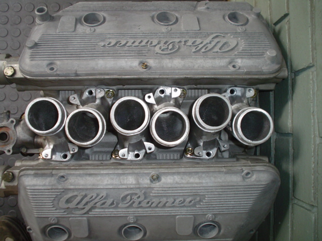

Hey Hot Legs Barry! Do you have a pic of the 6 ITBs with the plenums off? (I want to save my brother a trip back over there... (That square lawyer only knows how to step on the gas!)
John,Hi.
Yes ,I have already posted pics of the t/b`s.Will do so here again.

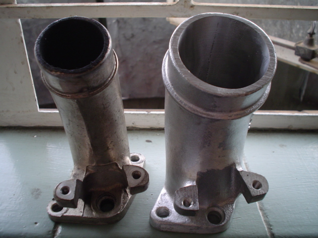

Guys,If youre running a turbo or anything bigger than a 2.5 ,considder the intakes-Those 3.2 and 3.5 12v engines out there,they need these big runners-period.
The good news is that with an adaptor plate they will fit a 24v engine as well.

:lol: Sorry,wrong pic---
