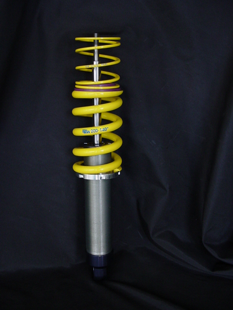

Totally agree with Andrew here-Dont touch the rear anti roll bar-On my gtv turbo I removed the bar completely.Work your frnt suspension to make it handle.When you reach serious limits you can start looking at camber on the rear.(and rear bars.)
Look at Ron Simmonds coil over setup or my KW setup-Sachs also do a great coilover setup in South Africa.
